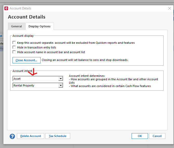

  • Quicken FranciscoQuicken Francisco Moderator mod
    Hello @mfaulken
    Thank you for reaching out on the community and telling us about your issue. We can try this to see if we're able to get it back to where it should be. Could you right click on the account and select edit/delete account. Once here select display options. At the bottom you'll see options to re categorize the account to get them into the correct spot.
    Please let me know if this helps you out!

  • mfaulkenmfaulken Member
    Hi Quicken Francisco,
    I tried this earlier and I don't remember what they were but they were consistent with an Asset account instead of an Invoice account. Since then, I restored to a previous version but as soon as Q synced it went back to an asset account. I restored again and this time I un-checked the box allowing the account to sync. and it's back to where it was as an Invoice account. I assume if I were to allow it to Sync it would revert to an Asset account again.

    Evidently, the Quicken update changed the attribute of my Invoice account from "Invoice" to "Asset". Apparently, it can not be changed back. Once I restored an earlier backup, I checked and that attribute for the Invoice account was changed back to "Invoice" account, instead of an Asset account.
    I too did a sync to the cloud and that apparently restored the old corrupt version. I have now again restored from an earlier backup, then reentered all the data from that time until now (fun). I have made a backup copy on my hard drive. It is possible that after my initial successful restore, that I should have right away done a sync to the cloud. But, when I started up Quicken again, then synced, it brought in what was there in the cloud (a corrupt version). Not quite sure on this point. Anyway, I am up and running again.
