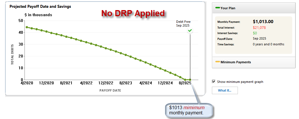

STEP 1 - Open and create a debt reduction plan baseline.
Baseline
Original debt plan (no DRP applied)

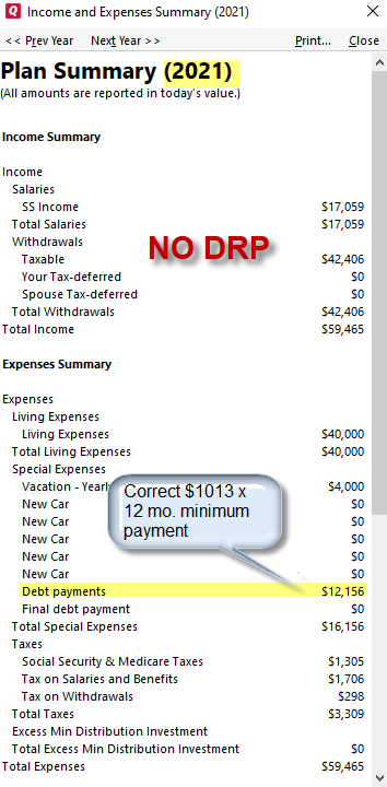

STEP 2: Turn on Debt Reduction Plan in Lifetime Planner then inspect all years in Lifetime Planner for correct reporting of baseline plan time-frame and correct "debt payment." NOTE, at this step you will not have created a "what if" payoff scenario, yet.
What it looks like in LTP in Year 2021 – CORRECT RESULT
Note 2020 will show a reduced, pro-rated expense in LTP

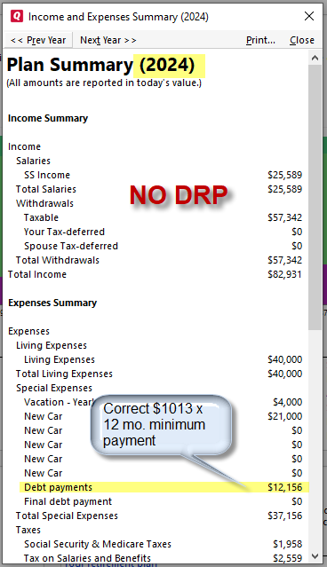

What it looks like in LTP in Year 2024 – CORRECT RESULT
Note 2025 will show a reduced, pro-rated expense in LTP

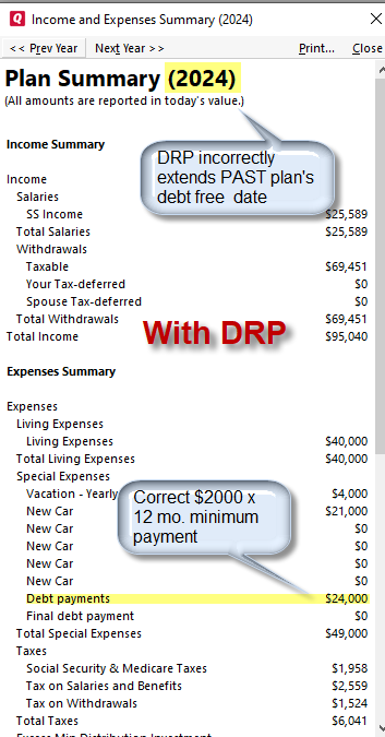

STEP 4: Now, go into Lifetime Planner then inspect (again) all years in Lifetime Planner for correct reporting of the "What if" payoff scenario created in Step 3. Here-in lies the problem....
What it looks like in LTP Year 2024 – INCORRECT!
Increased debt payments ($2000) continue to be applied to the plan’s BASELINE debt plan - 04.2022 through 08.2025.
Increased debt payment of $2000 should only be applied in LTP from 2020 to 2022.
Instead, the debt payments extend 3 additional years (at the new increased monthly payment) to the original plan date of 2025!
In my test file, the extra expense resulted in a $283K reduced balance at end of plan.

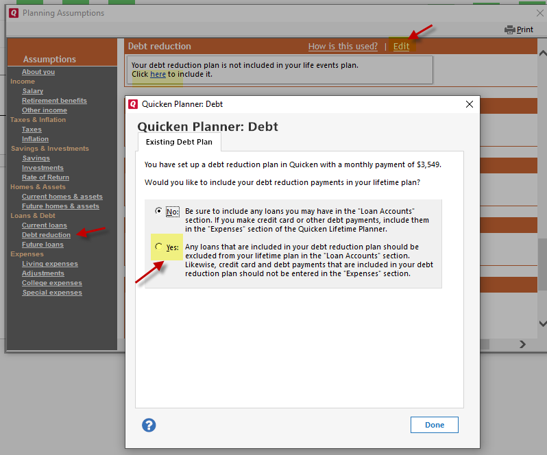

To be sure ...after you've created a DRP, go into Planning tab>Lifetime Planner>Change Assumptions>Debt Reduction. Do you see and can click the menu item called debt reduction in the Assumptions dialog? See image. If so, then can you click edit in the debt reduction pane? Doing so results in a window that allows you to turn on DRP in LTP. See image.
For you, where does Quicken "break" process?
