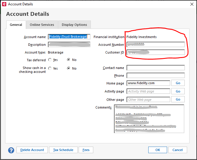

    • General tab > remove all Financial Institution Information from the upper right corner (area circled in red).
    • Repeat these 2 steps for each account with that FI.
