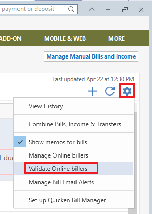

    11. Go to the Bills & Income tab
    12. Click the Gear icon on the top-right
    13. Select Validate Online billers
    Once that's done if the issue persists or gets corrected.
    You can also try super validating which are the same steps as above except that you will hold Ctrl and Shift on your keyboard when clicking on Validate and Repair in order to get the option for Super Validate.
