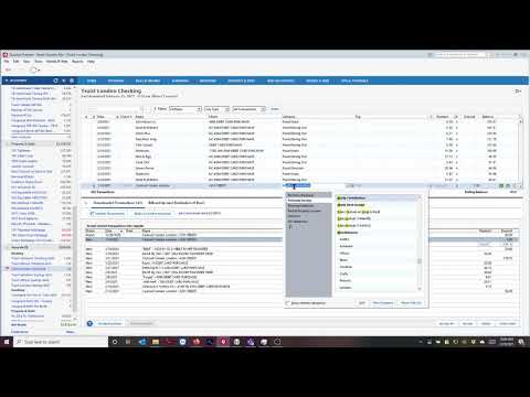

I am having performance issues. Accepting downloaded transactions usually takes up to10 seconds per transaction once I click "Accept" or the enter icon.
Switching from one account to another causes the quicken screen to jump around and takes about ten seconds as well.
I did a video screen capture of this behavior here:

    IMHO, viewing the video and, compared to my computer, I didn't see any marked slowness in accepting a single downloaded transaction. A second or two seems normal to me.
    706 categories
    Do you really need that many categories or could you perhaps prune the tree a little?
    How many nested subcategory levels down do you go? 1, 2, 3, ... 16?
    Rollup from a subcategory level to parent levels all the way up to the top income or expense total can consume some time, to calculate the numbers and store them in the database.
    How many named budget tables do you have? It's my understanding that Quicken updates all budget tables on file, whether used or not, with every transaction you enter. If you have several unused budget tables, consider deleting all but the current budget table for this year.
