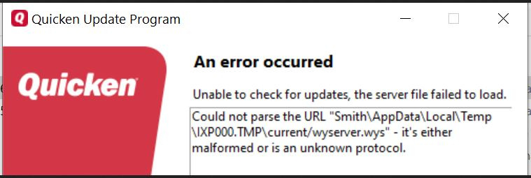

    When I attempt to execute the Mondo patch to revert to R33.24, the update program fails with the following error:
    Could not parse the URL "Paul\AppData\Local\Temp\IXP000.TMP\current/wyserver.wys" - it's either malformed or is an unknown protocol.
    The IXP000.TMP folder is created at runtime of the patch, so is being properly created, and is removed when the patch program is closed.

    I rebooted my PC and again attempted to run QUP to revert to R33.24, again received the same error:
    Note that the path to my AppData folder contains a space (c:\Users\Dave Paul\AppData) which appears to be mishandled in the message above, though the temporary folder is being created and deleted successfully, as is the file "C:\Users\Dave Paul\AppData\Local\Temp\IXP000.TMP\current\wyserver.wys".
    This error occurs even when Norton Auto-Protect is turned off.

  • UKR
    UKR SuperUser ✭✭✭✭✭
    The quickest way around this old, often reported but apparently as yet unresolved installation script error is:
    Create a new local Windows User Account with Admin privileges and with a single word as the username, so that the path does not contain this blank space, e.g., C:\Users\Dave\AppData\...
    Logon to this new ID and run the installation Mondo file
    When done, log on to your normal Windows user name and run Quicken and everything else as usual.

    @UKR, I appreciate that, but I should point out that I have had no problem over many years using QUP (executed from within Quicken) to apply any previous Quicken patch, including R34.13 just this morning, on the same system and using the same temporary path. I'm hesitant to try to employ workarounds like this a) because of the significant time it will take, and b) because there are clearly other issues pending resolution with an updated patch that could properly resolve this issue also. It seems more than possible that this issue was in fact resolved in a previous patch cycle, but that this issue has reappeared due to a code regression or the repetition of a previous coding error.
  • dwpaul
    dwpaul Member ✭✭
    edited June 18
    @UKR, instead of creating the new admin account, etc., I simply downloaded the install executable at https://www.quicken.com/support/how-do-i-download-quicken-quickencom-after-i-buy-it, and let it uninstall, reinstall and apply the latest released patches to Quicken. Since the problematic R34.13 is no longer the current release, only patches up to R33.24 were applied, and I have now regained access to my data. Unlike the standalone Mondo patch file, the patch routines built into qw.exe do not have a problem with the space in my %AppData% path.

    Tried Mondo Patch mondo_27.1.34.15_27.1.34.16 and mondo_27.1.34.16_27.1.34.19, both result in this error.
    Having developed applications for 28 years, I am very surprised at the number basic install / patch problems with Quicken. Very disappointing.
  • UKR
    UKR SuperUser ✭✭✭✭✭
    bill505 said:
    And the errors just keep coming...
    Please refer to this discussion for details and a resolution:
    https://community.quicken.com/discussion/comment/20188722#Comment_20188722

  • bill505
    bill505 Member ✭✭
    I created a new Local user account with Admin permissions per the Quicken support article:
    https://www.quicken.com/support/patch-error-unable-check-updates-server-file-failed-load
    ... Just more / different type of errors. Again, very disappointing.
