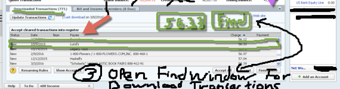

    Quicken . can you add a search/ find bar for the downloaded transactions ? when i pick up a reciept i could then just type into the "find" bar the amount on the receipt and that transaction would jump to the top vs scrolling thru a 100 entries looking for $56.33 (for instance) boom, there it is i can add a memo or recategorize and i'm done! next!

    yes, that would help speed up the most tedious part of the whole process!

    mikesauto i completely agree. i too match receipts and the easiest way would be to take a slip off the pile type in the amount in a "search "window specifically for downloads and have it pull the matching entries to the top. i'd would then add a memo or review a split etc and on to the next one. Mike is right, the scrolling is tedious and the worst part of quicken-Getting accurate data in . Quicken already sees the value of "search" as it uses it up in the body of entries made. I am just asking for the same usefulness for downloads. Please and thank you:)
