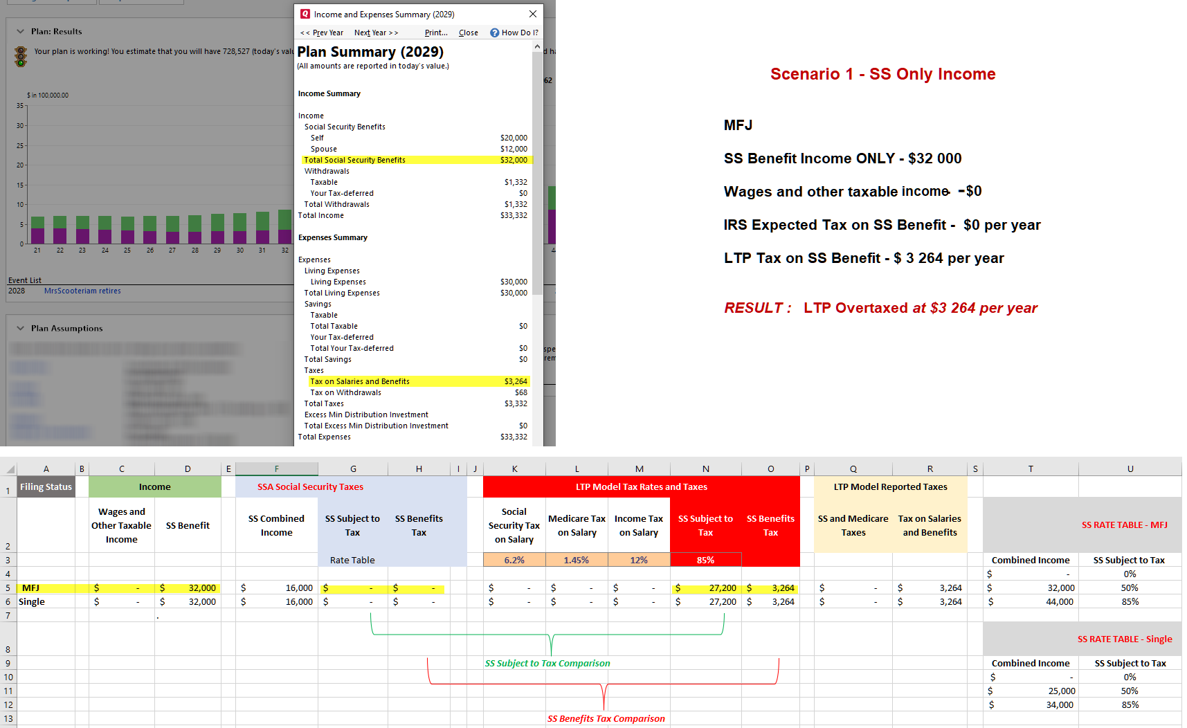

SCENARIO 1
SS benefit only resulted in an excess of $ 3,264 per year taken as SS benefit taxes in LTP over the SSA model.

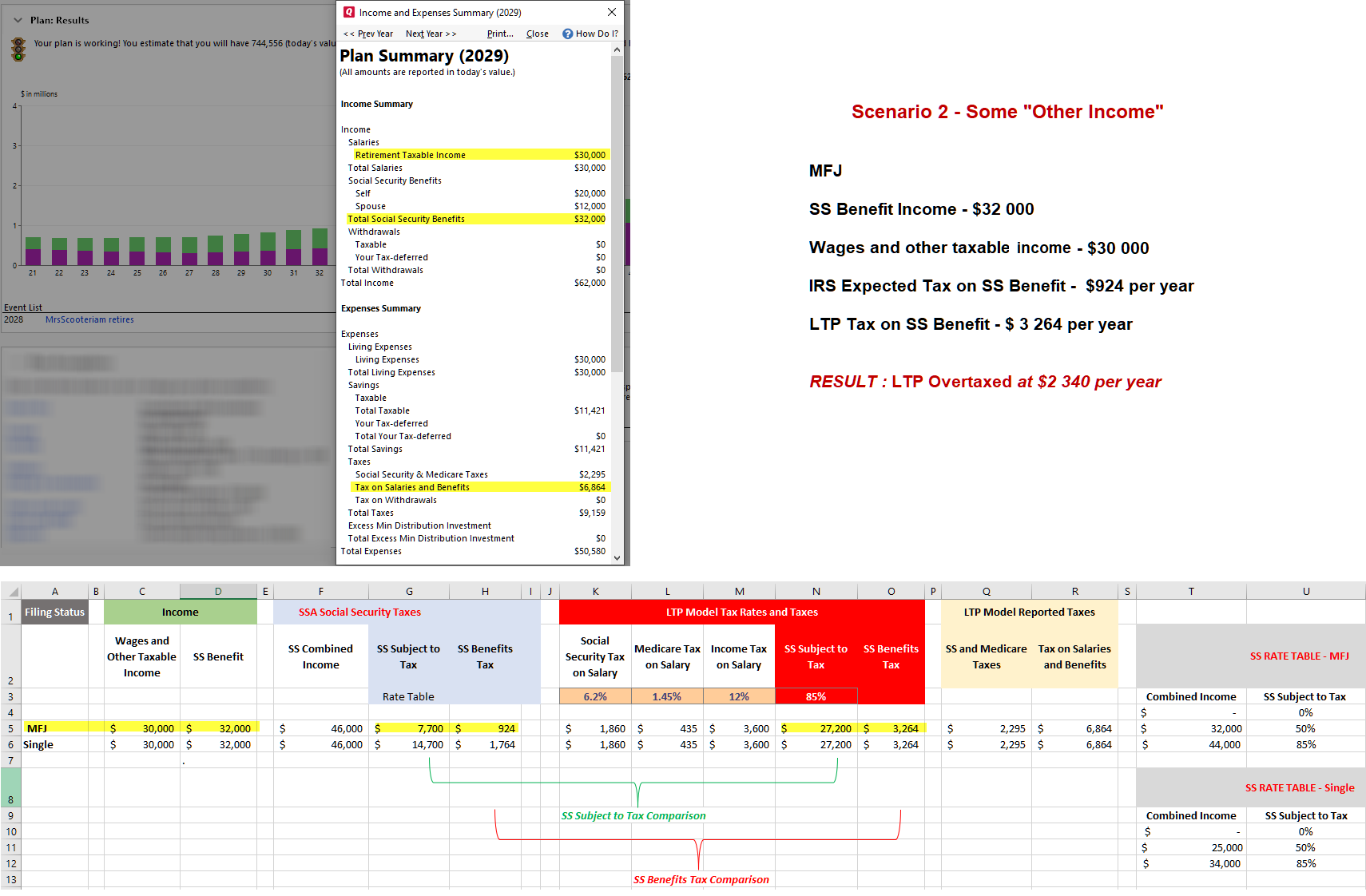

SCENARIO 2
Additional AGI added to SS Benefit resulted in an excess $ 2,340 per year  taken as SS benefit taxes in LTP over the SSA model.

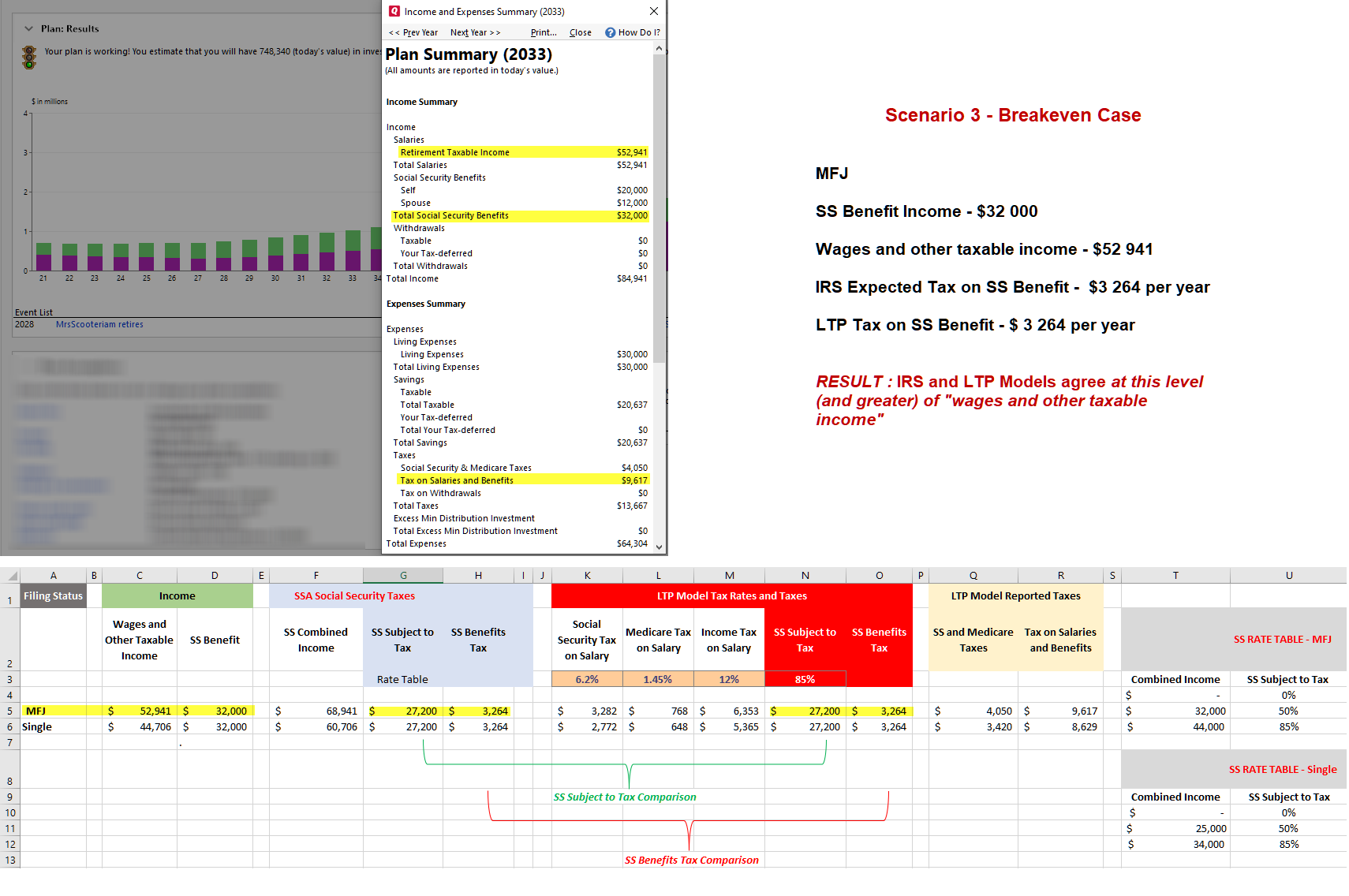

Break-even case where both LTP and SSA models agree. This particular case assumed $52,941 in AGI.  Note greater levels of AGI does not have any effect on taxes due to 85% limit.

For the LTP user with combined incomes shown in Scenario 3, both SSA and LTP models result in the same tax on SS benefits.  That is, above a certain combined income, 85% of benefits are taxed and LTP's simplified model is correct.  Note, currently the maximum amount of SS benefit subject to tax is 85%.

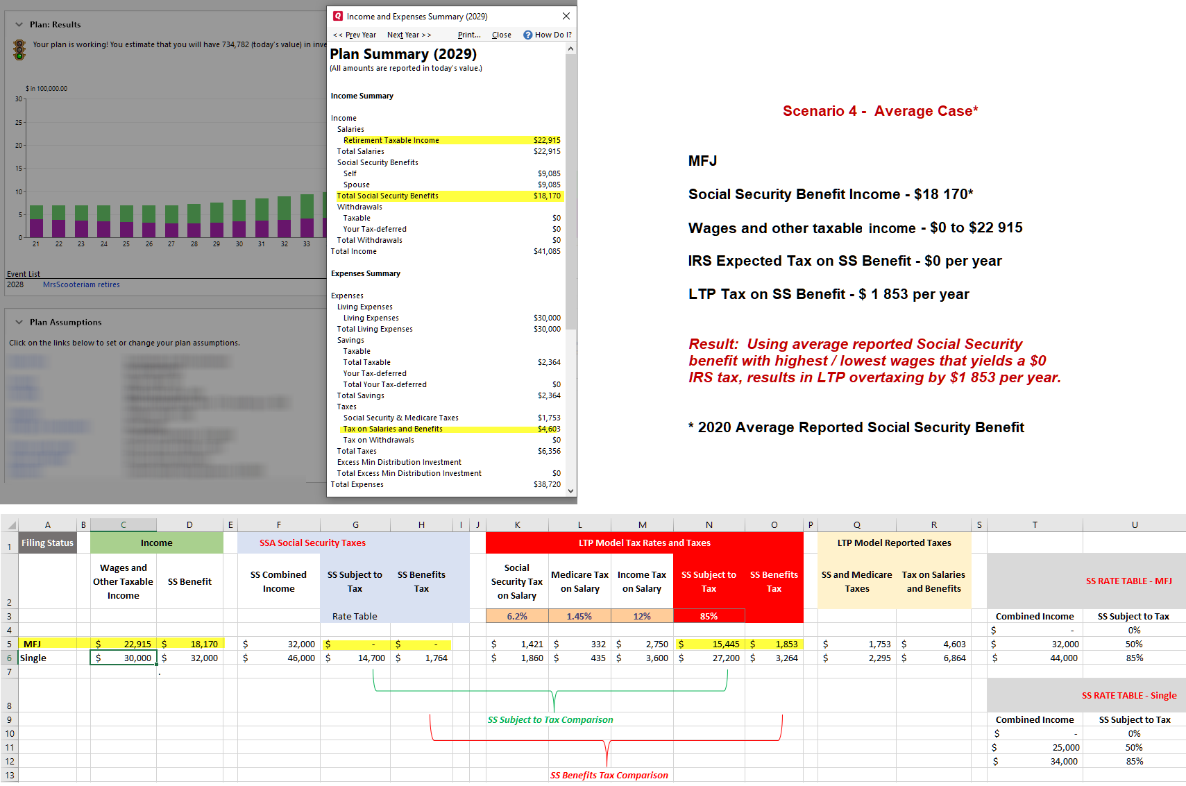

According to SSA, just under half of all SS recipients in 2020 pay no tax on their benefits.  For these users paying no tax on benefits,  LTP's model is overtaxing this SS benefit tax and thus reducing end of plan balances.   By how much???   It varies!
Additionally,  SSA reports 2020 average SS benefits are $ 18 170 per year.  Using this average benefit amount and assuming that all average benefit recipients pay no tax on benefits, Scenario 4, below, indicates that  LTP would overtax that user group by $ 1 853 per year!
Over the retirement plan horizon, in my simulation, this can result in a reduced end of plan balance by as much as $150K in todays dollars.  That's enough to fund retirement by another ~5 years.
To illustrate, I set SS benefit at the average,  $18 170 and varied AGI from $ 0 to $ 22,915, a level of combined income just below the taxing threshold.   Scenario 4.
SCENARIO 4
LTP Model Overtaxing SS Benefits for the "Average"  SSA Benefit Recipient
Yes, I realize conflating those two stat. populations may not be 100% correct....that is, assuming that average beneficiaries also pay no benefits tax (because there are other things that make up combined income).    Yet, IMO, Scenario 4 figures are not unreasonable.    But it is clear from Scenario 1, 2 and 4 that there is a drag on plan results resulting from the LTP model.
