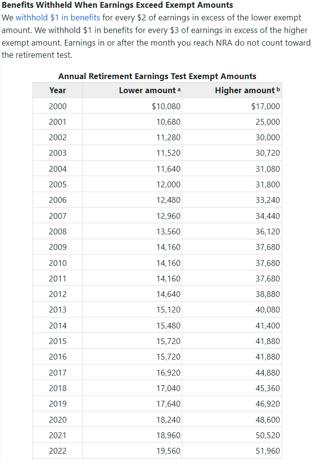

The Social Security Administration (SSA) uses a Retirement Earnings Test to determine how much to reduce benefits when the beneficiary is also working.
Two reduction thresholds/schemes are defined by SSA, a "lower amount" applies prior to full retirement age and an "upper amount" for the year of full retirement age. Image 1.
CHANGE SUMMARY:
Update and maintain Social Security Retirement Earnings Test (RET) thresholds in Lifetime Planner.  In LTP, these thresholds are out of date and appear to use a simplified RET model with a higher than expected threshold amount and reduction factor.  The correct earning thresholds and reduction amounts are progressive, based on earnings and age. Image 1

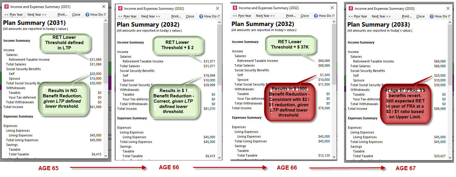

1.   In LTP, there exists only 1 RET threshold at $31,069 of wages (Image 2)     This value is much higher than the current SSA "lower amount" of $ 18,960 for 2021.   Also, it appears that the "upper amount" is not used in the model.  Cannot find / derive  the source / rational for this $ 31,069 threshold.
2.   In LTP, there exists only 1 reduction scheme commensurate with #1 (Image 2) and that is, for every $2 of excess earnings, the SS benefit will be reduced by $1 is currently implemented.   There appears to be no reduction value of $3/$1 normally associated with an "upper amount" ( see #1).
3.   In LTP,  Social Security benefits revert back to original levels in the year of FRA (67).  Expected to see an upper threshold applied at FRA (67) and benefits restored at 68. Appears that benefits are restored early at FRA (67). Image 2.   Does LTP recognize FRA based on AGE as recorded in "About You"?

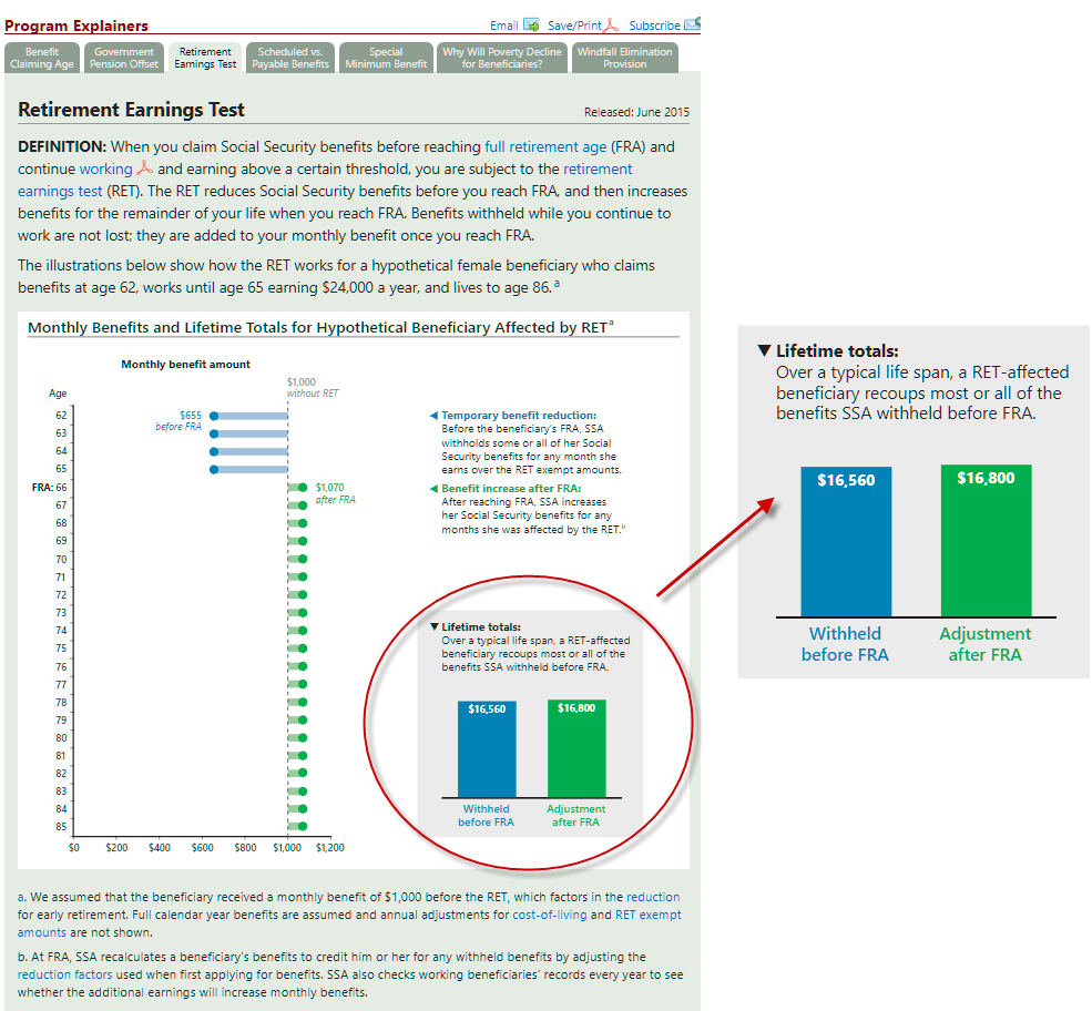

4.   In LTP, reduced earnings, due to RET,  are not "paid back" after Full Retirement Age is attained.   In essence, reduced earnings are not lost, but amortized after FRA.  Example in Image 3.

6.   past post in 2017 indicates, from testing, an outdated LTP earning threshold of $14,160 with a 2/1 benefit reduction thereafter.  There appears to be no "upper amount" at that time.  So, some updates were apparently made in the application but no help content update or published release notes to explain the change.
7.   In testing in 2021, using both new and existing "qdata" files, LTP earnings threshold now appears to be $31,069 with a 2/1 benefit reduction thereafter.  Image 2.  So, again it seems some updates were made in the application but no help content update or published release notes to explain the change.

IMAGE 1 - Retirement Earnings Test Exempt Amounts and History
IMAGE 2 - LTP RET Exempt Amounts and Reduction Values -  Age 65 to 67 (FRA)
Open in new tab to make bigger
IMAGE 3 - Example of RET
