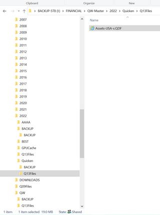

    This is a copy of the contents of my QW Master -2022 directory

    You appear to have changed the Windows default app by file type mapping to open a .QDF file with Internet Explorer.  I suggest you reset the .QDF file type to Quicken Windows.  If you haven't already, you may want to review: https://support.microsoft.com/en-us/windows/change-default-programs-in-windows-e5d82cad-17d1-c53b-3505-f10a32e1894d

    In your graphic, to the right of  the  highlighted  file, it says "Quicken QDF Backup".
    SO, why are you opening a Backup file and opening your  .QDF from within Q itself?  FILE,  Open
    Quicken file,  or  it's CTRL-O shortcut.
    If that Backup has your most recent data, RESTORE it using FILE, "Restore a backup file".
    And, per your graphic, are you running Q Canada?   Some of our advice MIGHT be a bit off.   Q CDA is very close  to Q US, but not identical. The name of the highlighted file in your graphic makes me suspect this.
