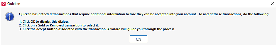

True, there is no "sort by order enetered", the dead give away is that you are in an investment account. Investment accounts do not allow the selection of multiple transactions, so even if you got them all in sequence, you couldn't select them for deletion. With investment accounts, you do the deletion from a Banking->Transaction report. Customize it to show just the account you are dealing with and then do some sorting and deleting.
-splasher using Q since 1996 - Subscription - Win10 -also older versions as needed for testing -Questions? Check out the Quicken Windows FAQ list
I haven't figured out a way to just accept all in an investment account when there's sale transactions. It actually takes less time to delete hundreds of transactions one by one than it takes to accept each sale transactions & match it up to specific lots, then sort and delete. Suggestions?

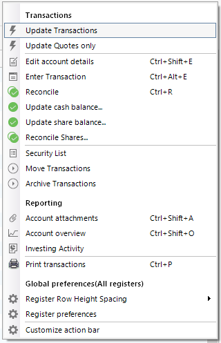

Click on the first transaction. Hold down the Left Shift Key and click on the last transaction to mark all.
Or click on the first transaction. Hold down the Left Ctrl Key and left click on the other transactions to mark. Now click on Delete.
Ctrl-A just brings up the Account List.
