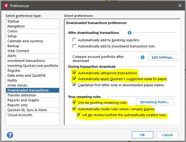

The only thing that I have ever played around with in "Downloaded Transactions" was to un check the box "Automatically apply Quickens suggested name to payee" Otherwise, everything is the same.

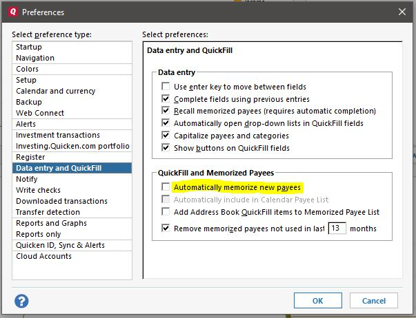

"Data entry and Quickfill is a different story where I have experimented with some different settings, admittedly not being sure about what I was doing but was desperate. "Automatically memorize new payees" is currently checked. All else is the same.

"Automatically memorize new payees" is currently checked. That's what I was hoping was the case. If the renaming rules are not perfect, any and all new transactions will get dumped into the Memorized Payee List. Any hope of rational category selection will be lost.
I would suggest taking a hard look at the Memorized Payee List AFTER removing the check mark from Automatically memorize new payees. You only want one, maybe two of the same payee listed, unless you have an unusual situation.

Data came in today. All categories were automatically assigned except for the splits (which is 75% of my dollars). Also, on the memorized payee list under the "type" column the "spl" is now showing up with a red color, indicating a problem. Was able to fix most by removing and starting over. Also, some items were checked for being "locked." I don't need locked items so I removed checked items. Closed list, reopened list and the checks all reappeared. Repeated process two more times and they are now gone. These are typical experiences for me with this app so I have learned to live with it and fix things over and over again. But I must be doing something wrong on the splits. Some of them I could fix by deleting and re-entering but others no. I'm confused by this and it may be a misunderstanding of the setup process on my part. Advice needed here.

I'm offering a dissenting opinion regarding enabling "Automatically apply Quickens suggested name to payee". This feature uses an internal list that often applies a name from that list which will leave you wondering "How did that happen?"
When it applies a name from the list, it is more often than not, wrong. The saving grace is that most of the time the downloaded name is preserved rather than being usurped by the list so it doesn't happen often. But if you happen to have a frequently downloaded payee that the list reacts to, it will annoy the heck out of you.

I will run it through with your recommended settings and see what happens. Will have to wait for a few transactions to accumulate though for a valid test.
Thanks for info. I did not know that.
