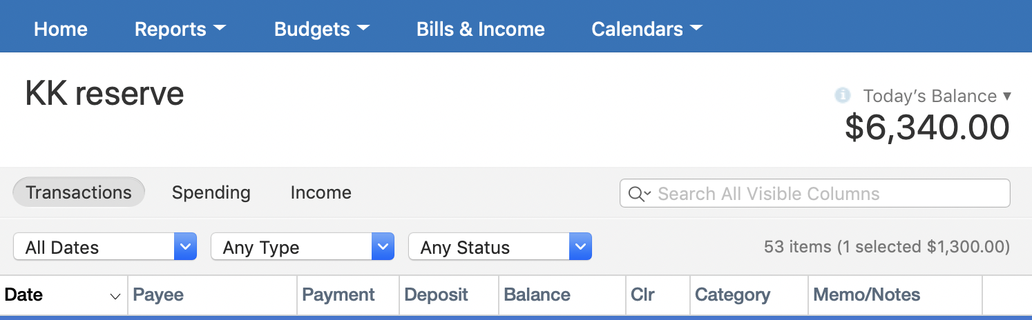

  • OK thanks John.  One of my accounts was set to 14 days so by changing that I am able to see the transactions I was looking for.  I appreciate your help. Since I may need it in the future though, can you show me the "Clear filters" button.  This is what I have:

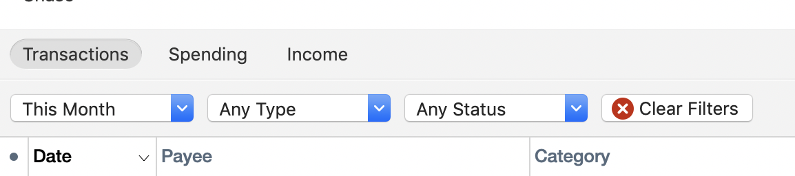

    The "Clear Filters" button will only appear when you have a filters set. Here is a screenshot of when I set one:

  • To see the "Clear filters" button, change any of the filters from their default setting. The Clear filters button will then appear to the right of the Any Status filter.
    PS: the three filters have default labels of: All Dates, Any Type, Any Status
