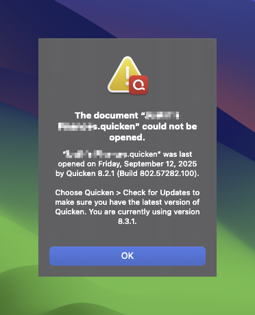

I innocently went along with the Quicken upgrade popup window as I started my day yesterday. It downloaded, relaunched, said it was upgrading my database, and then this:
So I sent the error in, still haven't heard anything from Quicken. Reluctantly, I go the chat support. "Alma" sends me this link, implying it's a known issue - You can click on the following link:  https://www.quicken.com/support/reinstalling-and-patching-your-quicken-subscription-version-after-your-membership-has-0/
At no time did I state my membership has expired, perhaps he was just giving me this link so I could redownload 8.2.1 (which I did). Uninstalled 8.3.1, reinstalled 8.2.1, data file loaded with no issues. I was able to download transactions, everything looked great.
I decided to try the upgrade again today, and got the identical error above.

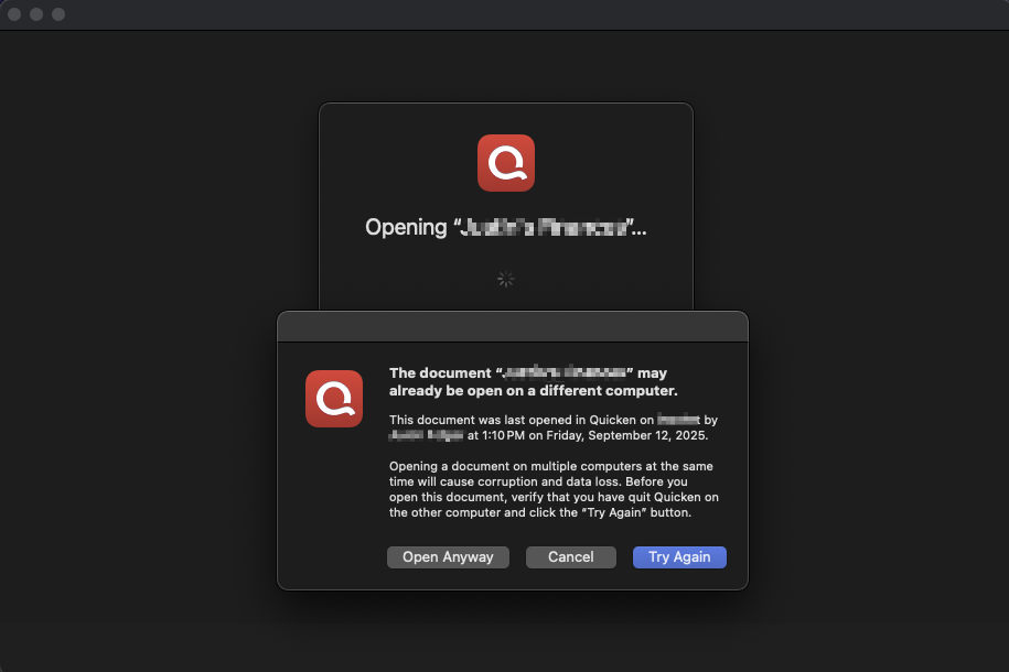

I am then presented with the usual no data file 'welcome' screen. I tell it to try and open my data file and it gives me this:
Any tips/advice appreciated.

    Reboot your computer to make sure there's no Quicken stuff running in the background. If you still get that "may already be open" error, click on "Open Anyway". I'd make a backup copy of your data file first.

    We worked with a customer who called into Support who was seeing this same error ("…could not be opened"). They sent us their file, and it opened just fine for us. So it has something to do with your Mac or your macOS user account or something else that's local to you. If you can't try a different Mac, try creating a different user account in macOS, then sign in to that user account and try it?
    I wouldn't expect re-downloading Quicken to make a difference.
    If the different user account in macOS doesn't make a difference, then I would try reinstalling macOS? I think you can do that without affecting user data (just install it on top of the current installation). But that's definitely a last resort!
    BTW, when you see the "…may already be open on a different computer" alert, that's just a warning. As long as you're not opening your file simultaneously on multiple Macs by sharing it through Dropbox or iCloud Drive or something, you can just ignore that warning and click "Open Anyway"
    When Quicken opens a file, it creates a little metadata file inside the .quicken folder, in a "locks" folder. And when Quicken closes the file, it deletes the file it created. So if Quicken encounters a file in the "locks" folder that it didn't create, it warns you, because that's exactly what would happen if you were sharing the file between multiple Macs using Dropbox, and it's still open on your other Mac. That was a big issue in the past, and this warning is how we try to prevent people from accidentally screwing up their file. Hope that helps!

    Sorry to hear you’re experiencing this problem. I see that you mentioned sending in an error report about this yesterday and I was able to locate the feedback you submitted.
    I took a look at the ConsoleLog.txt file that was provided and what I noticed are disk I/O errors that might be preventing the upgrading of the database. You might be able to see these messages if you open Console.app and look.
    There have already been some good suggestions, but I’d like to add a few more. You might try duplicating your file and then attempting to upgrade the duplicate version. Another option is restoring a backup and checking if that succeeds.

    I tried a 3 month old backup data file, had the same issue. So put a copy of my latest data file on another user account on the same Mac, installed 8.2.1 in that other user account, and like magic, it upgraded everything with no issues. Brought that data file back to my own account, opened it, everything is working as expecting.
