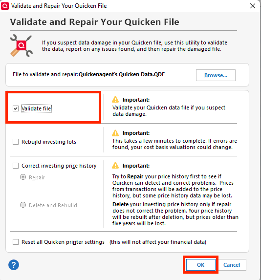

As a next step, I recommend running a file validation to check for any data integrity issues. Here's how:
Go to File > Validate and Repair File >Check the "Validate file" box >Click OK.Once the process completes, Quicken will generate a data log that may provide more insight into what's going on. Take note of the end result. Does it return no errors? Were there damaged transactions that were repaired?
