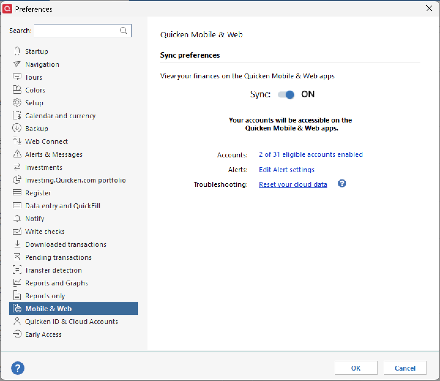

This happened to me too. I restored from backup and got the budget back, but when I tried to update from my financial institutions again, it deleted the budget.
To clarify, in your case, the budget is disappearing when you do a One Step Update. Is that correct?
If so, I would restore a backup again, like you had before. This time, before updating your accounts, check to see if you have the cloud sync turned on.
To do this:
- Go to Edit.
- Select Preferences.
- Click on the Mobile & Web tab.
- If your Sync is turned on, then you should see some options.
- Click Reset your cloud data.
Wait for the reset to finish, and check to see that your budget is still present. Now try the One Step Update and see if it still causes the budget to disappear.
Note that doing this could interrupt your connections to Express Web Connect +, which is a connection method that some of your financial institutions use. If resetting the cloud works and fixes the budget disappearing issue, you may need to reconnect some of your bank accounts. If resetting does not work, then restore the backup once more.
Let me know how it goes.
