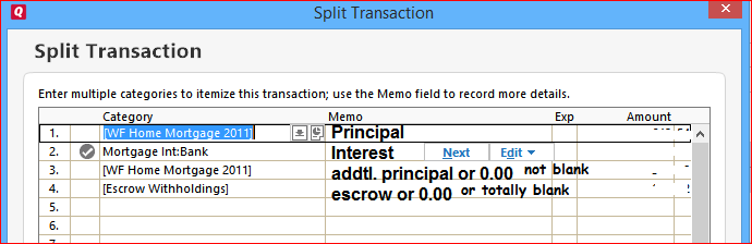

Either way, the process of setting up the loan account in Quicken offers you the option the create a Scheduled Reminder or an entry in the Memorized Payee List. Either one contains the required Splits for Principal, Interest, additional principal (if any), Escrow withholdings (if any).Here's an example how my offline mortgage account's reminder once was defined:

One thing I neglected to mention in my earlier response is that, once you have the Scheduled Reminder set up, you should record it into your registers BEFORE you download transactions into the checking account containing the payment confirmation. This way, you have a valid transaction with all the Splits already in the register and the downloaded transaction will simply match to it.
The Loan Setup process will create a Scheduled Reminder which has the correct amounts for Principal, Interest and optional Escrow already calculated for every monthly payment you make. Normally there should be no need to make changes to the splits every month, but it doesn't hurt to compare the amounts with your monthly loan statement from the mortgage company.
