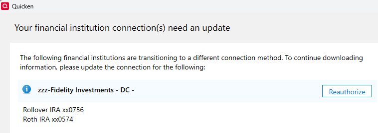

BUT, when I do subsequent updates, Quicken asks to reauthorize two Fidelity accounts that were closed long ago.

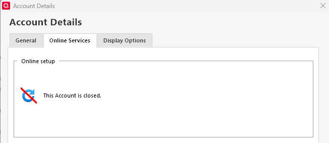

Account Details→Online services only says "Account is closed". No deactivate option

AND if I run through the reauthorization process again, nothing changes since that account was closed long ago, so the loop continues.

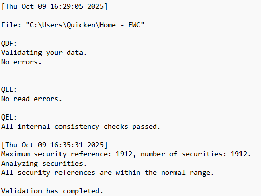

As I mentioned initially, the validate is clean.
After closing, waiting and re-opening, Quicken continues to wish to reauthorize these long closed accounts…
Fin kept suggesting I deactivate the account but as you can see, there is no deactivate option in the online services tab.
