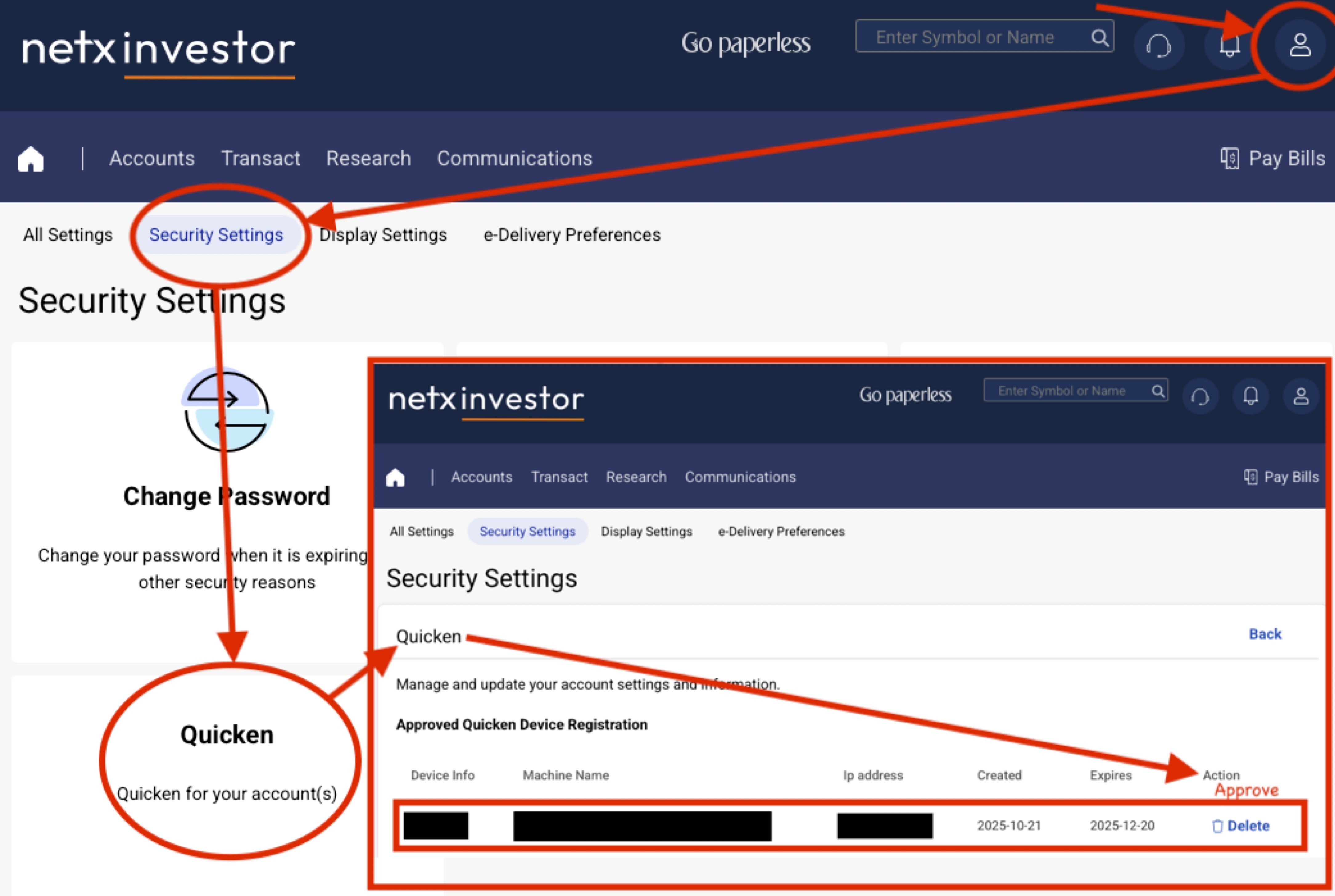

I hope you've been able to resolve the Pershing issue by now. If not, here is specifically what solved the issue for me. I found that there was a "Quicken" security setting in my Pershing web profile that I had to "approve" only once after I had configured the Pershing account in Quicken. It looks like the approval expires in three months and will need to be reapproved then. The steps I took are illustrated in the annotated screen grabs below. (I now see that one of my arrows passes through Change Password—ignore that because you don't need to change your password.)

I am Citi Personal Wealth Management (CPWM) client and while the color scheme is slightly different from what's shown here, CPWM uses a re-branded version of Pershing's netx investor system to service its clients, causing the same exact issue for me as everyone else had here. These instructions fixed it for me. I found that when I deleted and reconnected my CPWM account, at the screen where Quicken pops up the window to ask I what verification method I would like (SMS), after I pressed okay on that screen (i.e., after a text was sent but before I entered the one time passcode from the text), I come back to the page shown in the screenshot on Pershing's netx investor site, and that is when I discovered a pending Quicken approval. That solved it for me. Thank you!
Excellent! Thanks for describing the additional steps needed to get the Approval to show. It had been too long ago for me to recall these.

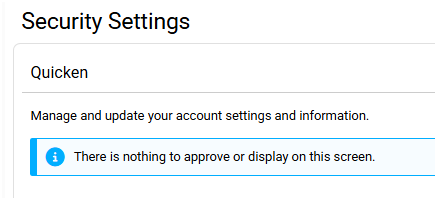

My issue still exists and none of the suggestions in this thread helped. I have tried to call Pershing to no avail. They had no clue and said they would call me back two weeks ago. My brother has the same advisors, same quicken and same pershing. His works great and he has never had to go to Pershing settings or click on anything. My Pershing settings has nothing there. "Nothing to approve or authorize"
