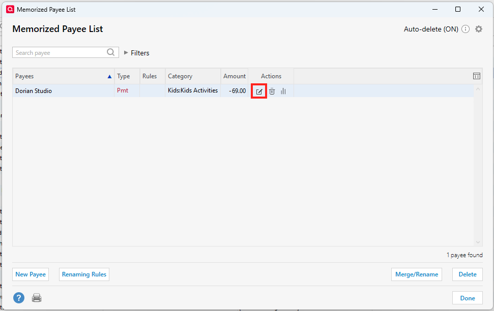

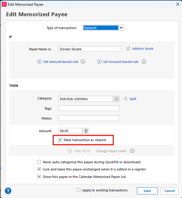

- Have you checked your Memorized Payee List in regard to the transactions being marked as cleared?
- To do this, go to Tools>Memorized Payee List.
- Locate the memorized payee in question and click the edit button.
- Uncheck "Mark transaction as cleared" if it is checked off.
I believe the issue with the memorized payee is now ok, with your help — the "marked transaction as cleared" was on for the payee. THANK YOU.
