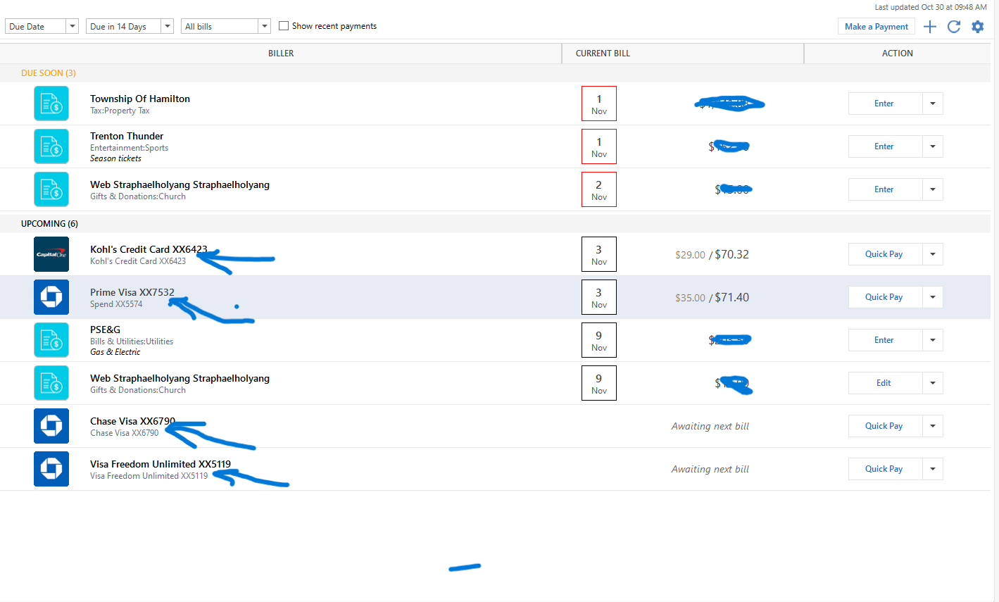

I rechecked all of the reminders and links. Interestingly, two bills did not show both minimum and full pay options until I switched to full pay. Everything looks good now, except for the two Chase accounts that show "Awaiting next bill."
All of the accounts are shown in the "Projected balance" graph, but I notice a difference in the Category shown between the Prime Visa and the other three accounts. I would have expected the same "Spend" account to be shown. Any thoughts? All show good links.

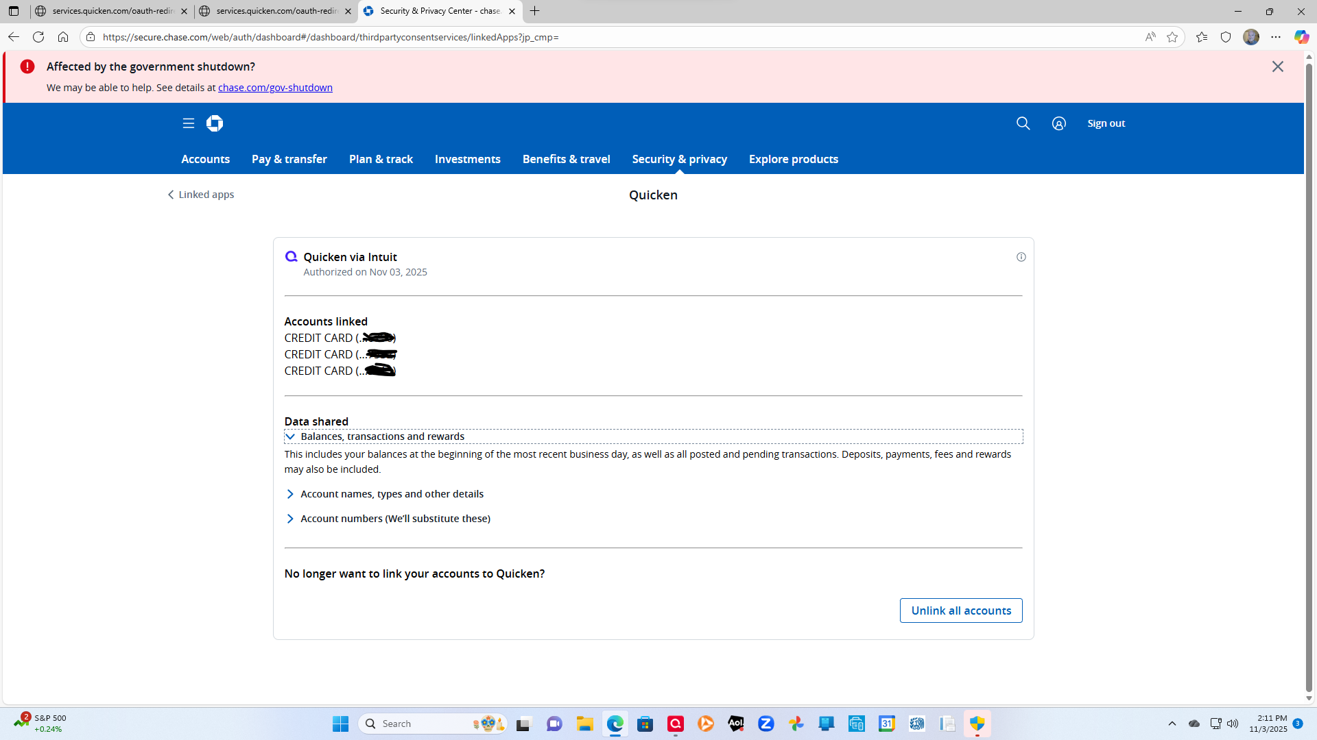

You can see in the screenshot above that my three Chase accounts are linked to Quicken. The day-to-day transactions update correctly, but the online bills do not update at all. I don't know if it significant, but the data shared, as shown above, does not include billing data.
I have a significant payment due to the Visa Freedom Unlimited card on 11/27 which should be shown. The Online bills for Chase will not update. I did use the "Pay" option for that card to pay on 11/27, which now, at least, shows in the projected balance of the spend account. What could be the problem?

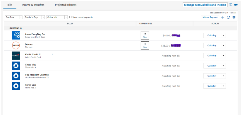

I have experienced the "Awaiting next bill" message with Chase credit cards since the cutover to the new provider. Had a call with first and second level support in October but still no status update or fix. If you go to "Manage online billers" you will probably see the information as bill date, amount due, minimum due, etc. However, that information does not appear on the main biller page. I reported this to support and shared my screen with the rep.
So far, this new more reliable system has dropped two of my billers and does not work properly with Chase which consists of 4 credit cards. Basically, it is worthless to me at this point.
