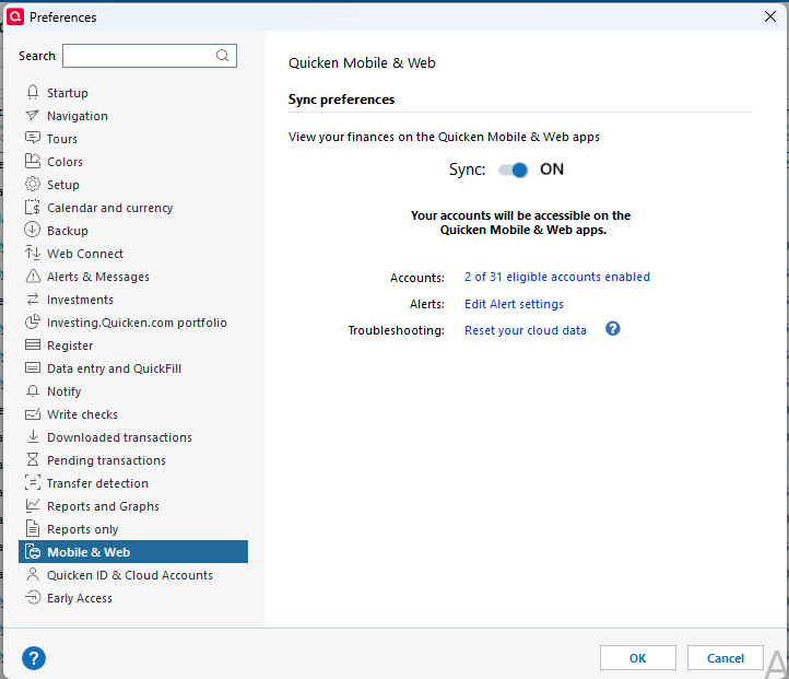

Can I have you reset your cloud data and then see if this issue persists?
To reset the cloud data:
- Go to Edit.
- Select Preferences.
- Click on Mobile & Web.
- Click Reset your cloud data, in blue.
Wait for the reset to finish, and let me know if the issue with reminders continues happening.
I have done the reset. Will see what happens and let you know in a couple of days. If this doesn't resolve the issue I will have to start to look for an alternative application.
I did the reset but still the same issue. I turned off the sync and that seemed to have taken care of the issue. I am going leave the sync feature off.
