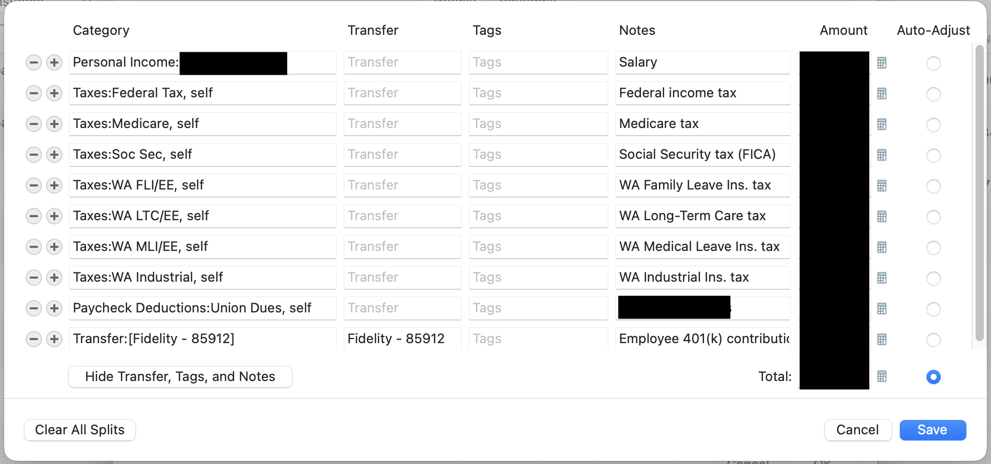

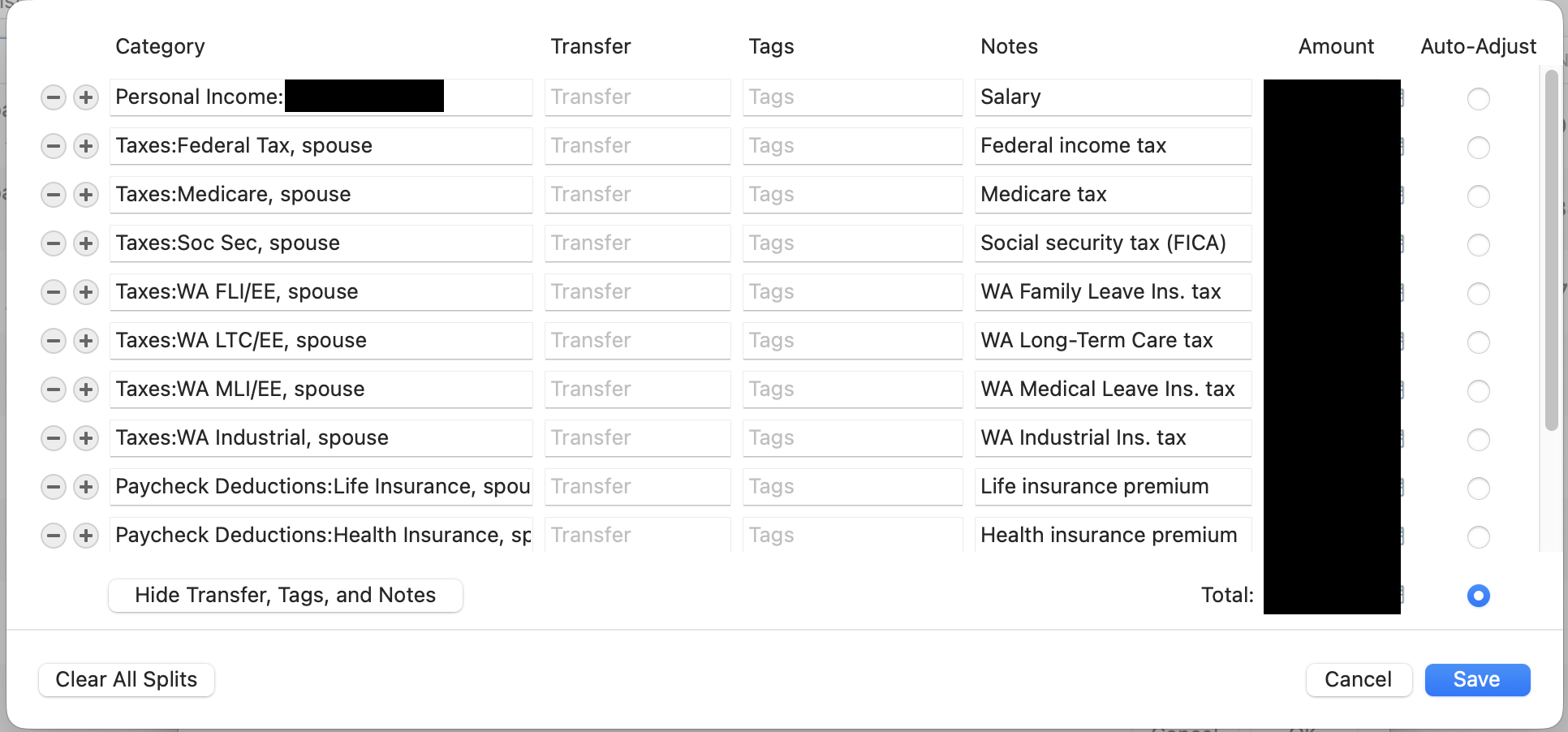

Thanks for your reply. Here is a screenshot of what I'm working with right now. The life insurance premium in the second screenshot is my wife's employee paid extra life insurance, not the employer paid benefit.
Like I stated in my OP, we each get life insurance benefits from our employers which is included in our taxable income. Her paycheck has pre-tax health insurance deducted which I do have properly recorded in her paycheck in Quicken. This reduces our taxable income.
I acknowledge this is super in the weeds in terms of tracking income, but if Quicken Mac can do it I would like to try.

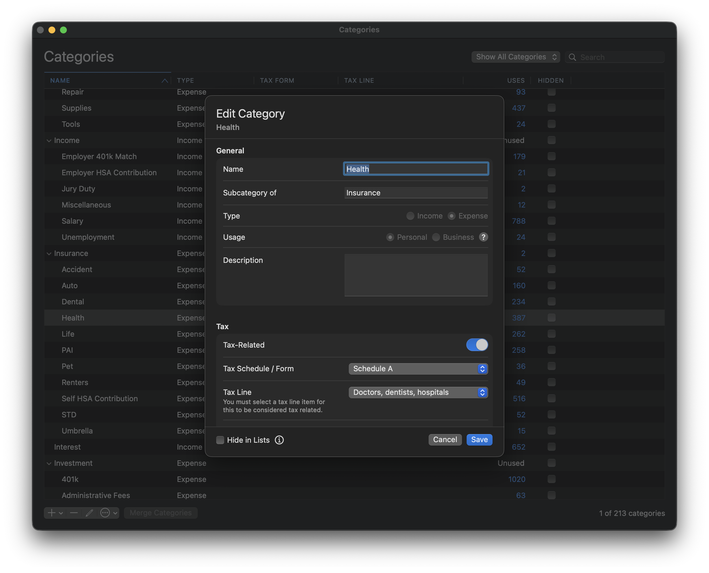

For your various tax deductions, you will want to go in to the Category list and edit that category and mark it as tax related. Then, you can add what IRS line/form it applies to. This will allow those lines to show up on Quicken's tax reports. Is that what you are asking?

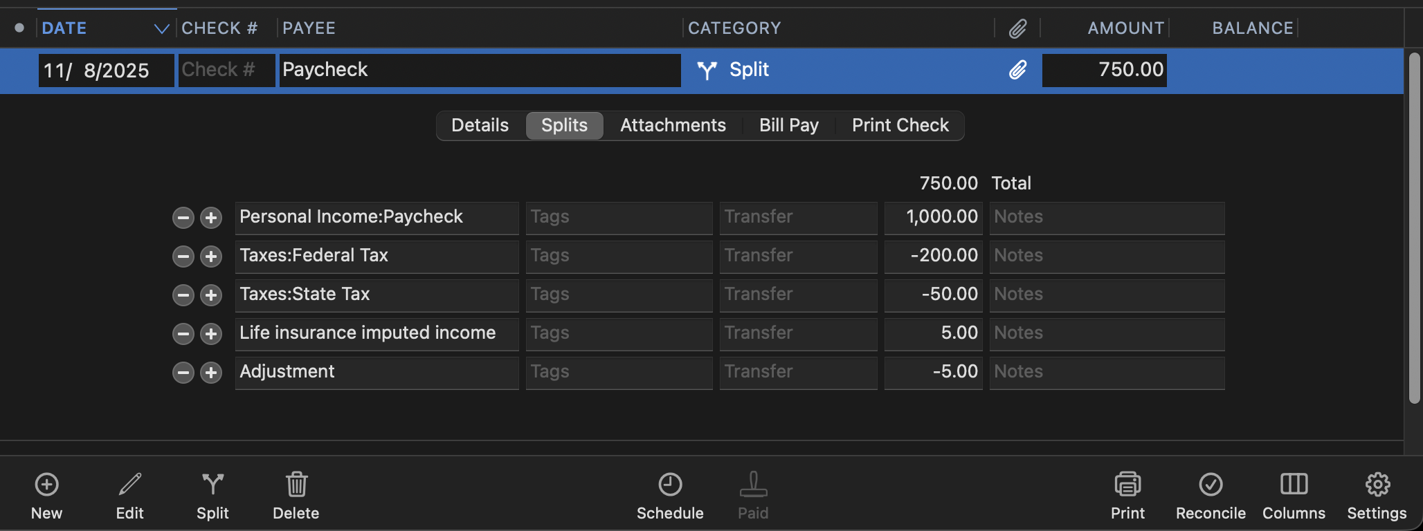

I don't think there's a great way to record imputed income like that since it doesn't actually result in a transaction in an account. The best I can come up with is to add two lines to your paycheck split - one for the imputed income and a second with an adjustment offsetting the inputed income so the total comes out right. Something like this:
If you edit the "Life insurance imputed income" category to mark it as tax-related and assign it to W-2 income, then it will be included in your W-2 income on your Tax Schedule report:
I'm not sure where imputed income is actually supposed to be reported, so that might not be the right tax line. It;s been almost a decade since I last had any.

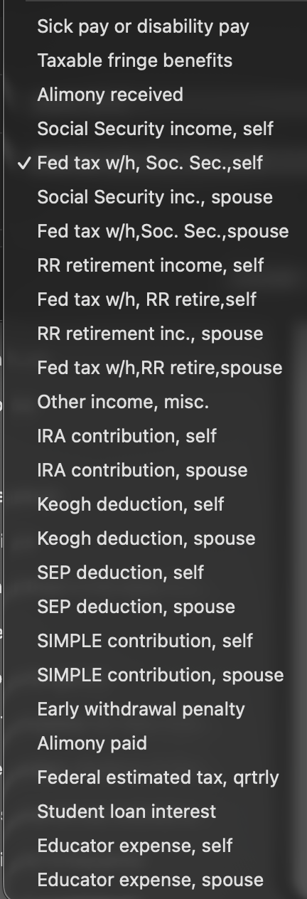

As for the Form 1040 report, it looks to me like that only includes categories that have been assigned to Form 1040. These days not very much actually gets on that form, most items have been shoved off onto one of the Schedules instead and those categories only show up on the Tax Schedule report.
This is the list of items that Quicken has associated with Form 1040:
