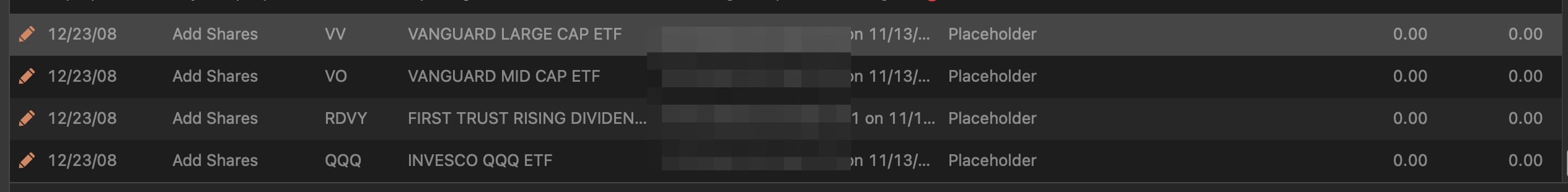

But now every time they update, I get a set of placeholder transactions for the funds that would not manually match, which doubles my share balances for these funds. I keep deleting the placeholders, but they keep coming back on the next download.

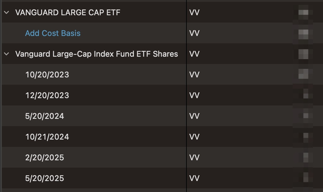

I've attached some screenshots that show the placeholders and an example of what the fund looks like in the portfolio view. The total quantity for each are exactly the same.

I don't think there are any serious issues here. What I suspect happened is that when you connected to Ameriprise, most of the Securities "matched" correctly, but the ones that keep getting placeholders were just different enough that Quicken is interpreting them as a being a totally different Security. Hence why you couldn't match existing transactions and why you keep getting Placeholders. You just need to merge those Securities so Quicken knows they are the same.
(And Placeholders are nothing more than share balance adjustments which is why your balance keeps doubling: Quicken is counting what is being reported and the amounts from the transx in your register.)
Don't sweat deleting the downloaded transactions if you already have the ones you entered in your file.
After you make a File:Backup of your data file, you will want to go into Window:Securities and locate the two nearly identically securities, and merge them so that Quicken now views them as the same. You select the two I the list, and click on Merge down at the bottom. Click through the merge process which is pretty simple.
Note: I suggest using the name Ameriprise is suggesting as the going forward name. Also, that name must have a Security type associated with it. I don't know what you are using for your ETFs, but make sure the type matches before you attempt the merge. The placeholder for that fund should disappear-and not reappear in subsequent downloads.
Repeat for each Security causing issue.

Thank you, this is exactly what I was looking for! It didn't even occur to me that there was a separate Securities window like Payees, etc. I was looking for the way to merge them from the Portfolio tab itself and only able to edit the individual security details there obviously.
I'm guessing there must be some other behind the scenes unique identifier other than the ticker symbol that it's using, and now that I'm reading up on ticker symbols and CUSIP, I do remember that some of the transactions I deleted had a CUSIP string in the Security/Payee field instead of a fund name.
The funds that didn't match, all the ones that got created from Ameriprise's download were Mutual Fund type, and all the ones that were created from when I manually entered the transactions and let Quicken get the new security from the ticker symbol were Stock type, so once I changed the types to match each other, I was able to merge them and now my share balances are correct again.
