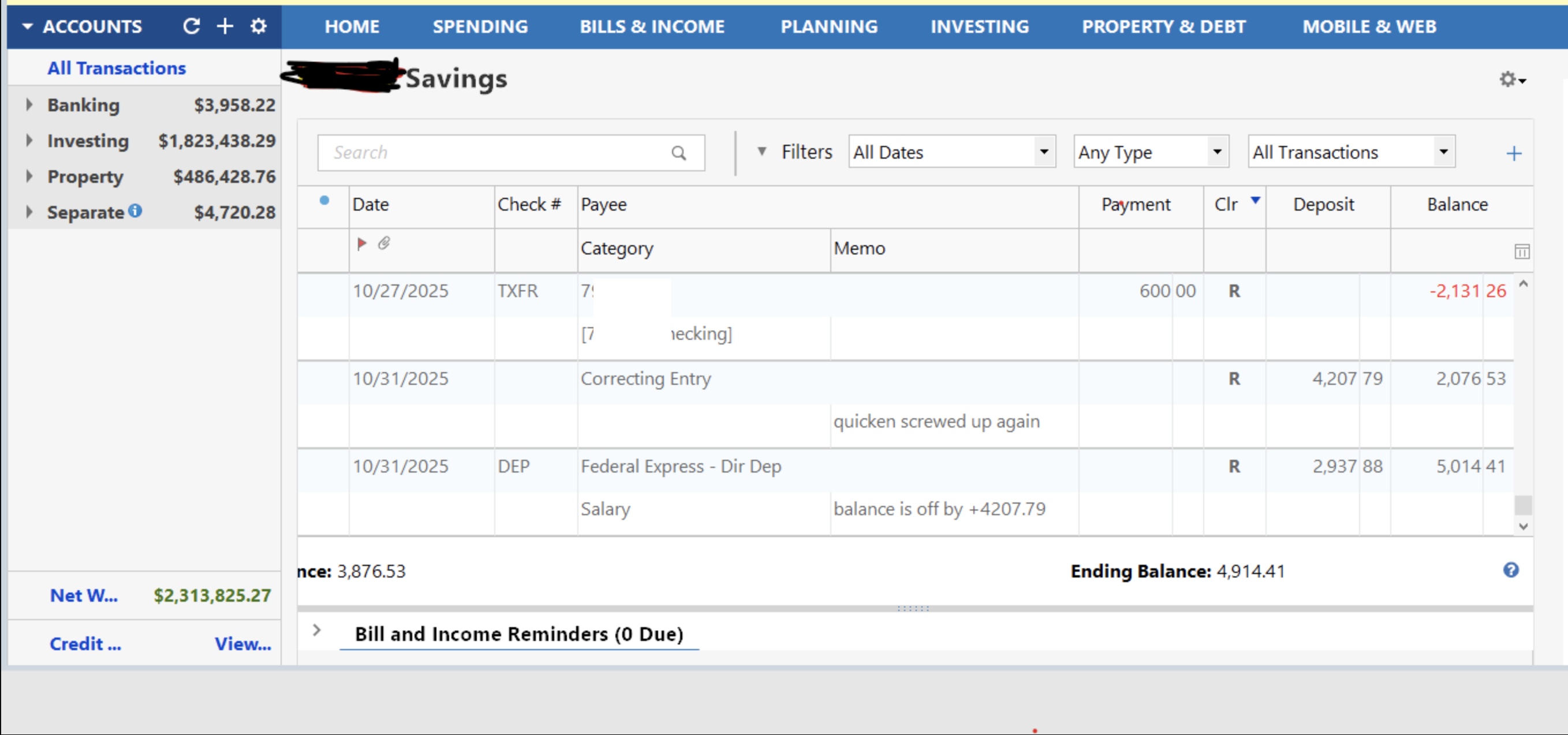

Has anyone else had this problem? And is there a fix? It's happened in multiple accounts. One day it's ok, the next it's off thousands of $$$.
[Edited-Screenshot]

Looking at the register image you provided, I just noticed that your account register is sorted by the Clr column. That means that your Balance column is meaningless. It's a top-down addition of all transactions displayed in the register.
Only when the register is sorted by the Date column in ascending order, newest transaction by Date at the bottom of the register, and not filtered to only show a limited number of transactions, will the Running Balance be correct.
To sort the register by the Date column click on the "Date" column header. A small triangle next to the column header indicates the sort order: "▲" pointing up for ascending or "▼" pointing down for descending sort order.
@cindag,
Just checking in to see if correcting the sort order fixed the issue you were having.
@UKR,
Nice catch!
