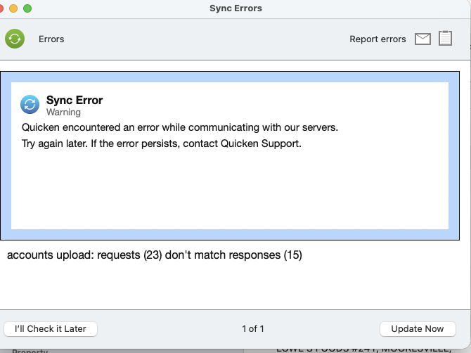

Why am I still getting a "Sync Error" warning with Quicken servers?

To troubleshoot, if you are seeing an "accounts upload: requests number:(#) don't match responses number: (#)" error, try the following steps:

Sync is turned off on my iMac and has always been off. I don't use Quicken Mobile and don't want to start using it. Do you have any suggestion for me to fix this problem?
I am getting the same error even though i also don't have sync enabled. my visa account is still syncing, but none of my others
Having same issue, none of my accounts update, last time worked was 1/16/26. Quicken please remedy this!
I too have the same issue with Quicken Classic premier version 8.4.2 on Mac. Difficult to beleive this is not solved yet. Any Qucken support watching this forum?
I am getting the same error with the same environment as others here: I do not sync anything with Quicken Cloud.
On another thread someone suggested going to Settings → Cloud and Services (funnily enough, for cloud services I do not use) and clicking "Reset" (on cloud services I do not use). Then I ran update as usual. That fixed it for me.
Hope this helps someone else. Clearly a bug in the latest release.
^^^Tribbiani's trick worked for me. Except with my version I went to Settings → Connected Services. Then clicked on "Reset" under Cloud Account. I also do not use any of the cloud services.
Tribbiani's trick worked for me too. ("Settings → Connected Services. Then clicked on "Reset" under Cloud Account")

Strange that the cloud sync would be causing an issue while turned off. I am glad to hear that resetting the cloud resolved the issue.
Is there anyone who was not able to resolve this by resetting the cloud?
I also had cloud sync off, experienced this problem, and the reset seems to have resolved it. [Removed-Speculation]
