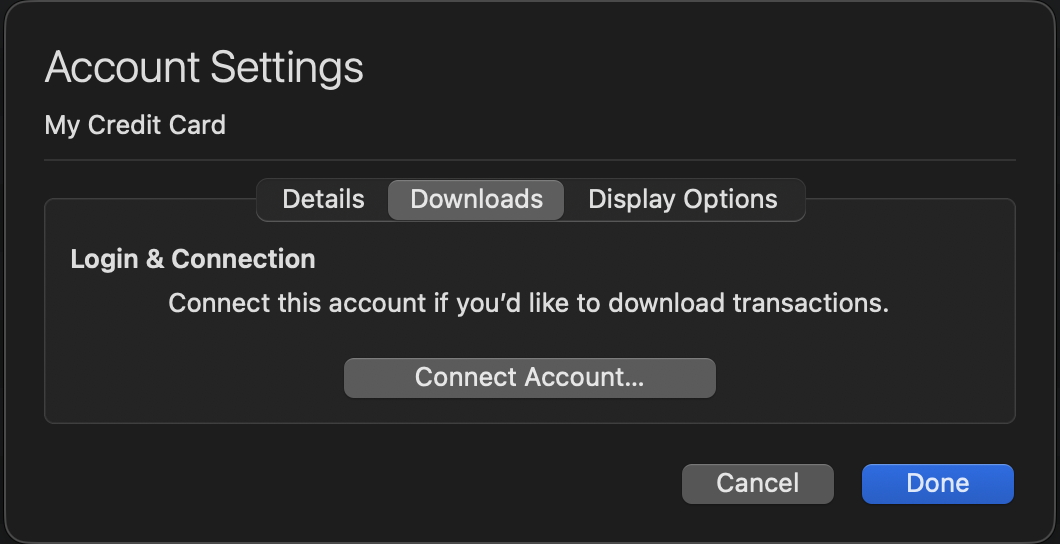

To Reactivate Account(s)
- Select the account to open its register.
- Click the Settings gear in the lower right corner of the register.
- Go to the Downloads tab.
- Click the Connect Account... button.
- Select the financial institution or type in the name to search for it.
- Click Continue and complete the flow.
- Choose LINK on the screen displayed after Quicken finds the available accounts at the financial institution for your login credentials, and carefully link to your existing Quicken account(s).
- Click Continue.
Once back in Quicken, you will want to make sure you choose the "LINK to existing" option for all accounts that are already in Quicken.
