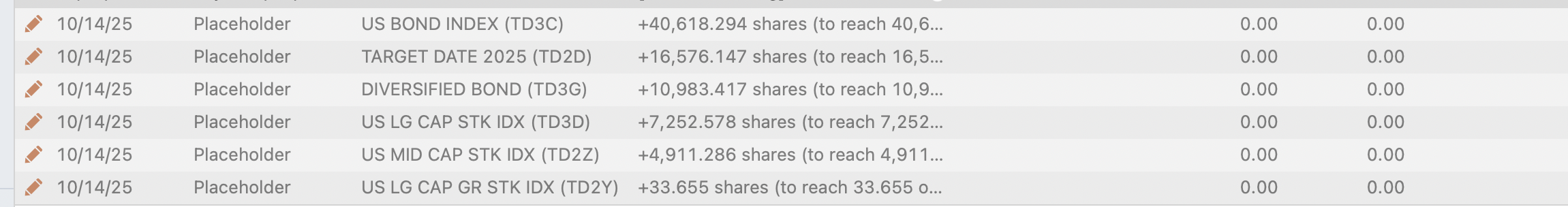

When I update Fidelity (which it is finally allowing me to do) it adds placeholders for each of my holdings, but gives them ticker symbol in the name download which seems to make the account think there is a separate set of share unaccounted for, essentially doubling my account. If I delete the placeholders they continuously reappear.
I have also seen this with two securities. Only two. No idea what could cause this. I tried every thing I can do to eliminate them. I finally deleted the original securities and left the "placeholder" ones. The duplicates stopped coming. There wasn't much trading history with those so not much was lost. Not an ideal solution.
