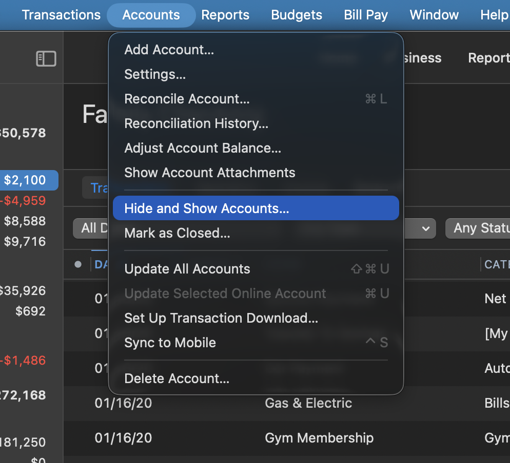

Hello @in2ndo,
After checking your connections internally, I don't see any errors, so that's good news.
If the accounts are not showing up to link to, that usually means they are still connected in Quicken. So I would double-check that they are disconnected first. If they are disconnected, the next thing to do would be to check for any old or hidden accounts that might still be connected, and disconnect them if you find any.
To do that:
- In Quicken, choose Accounts > Hide and Show Accounts.
2. For the account you'd like to unhide, uncheck the Hide in Lists checkbox.
3. Click OK.
Then, if needed, use the article linked above for steps on disconnecting the accounts. After completing those steps, you would use the same article for instructions on reconnecting the accounts.
Note: Loan accounts, like auto loans and mortgages, cannot be reconnected once disconnected; they will need to be added as new. Any other account should link just fine.
