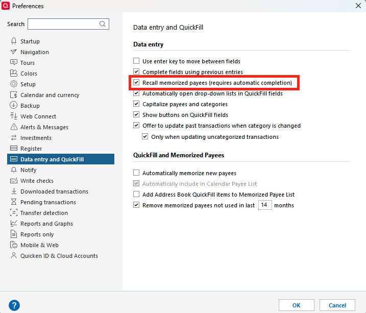

In Version 66.11, I started having a new problem that memorized transactions were not populating in the register even though the drop down of the memorized transactions were displaying. I reviewed the Preferences for "Data Entry and Quickfill" and found that a field "Recall memorized payees" was not checked. I do not know if this is a new field or if one of the updates cleared the field, but checking this field fixed both of the problems.

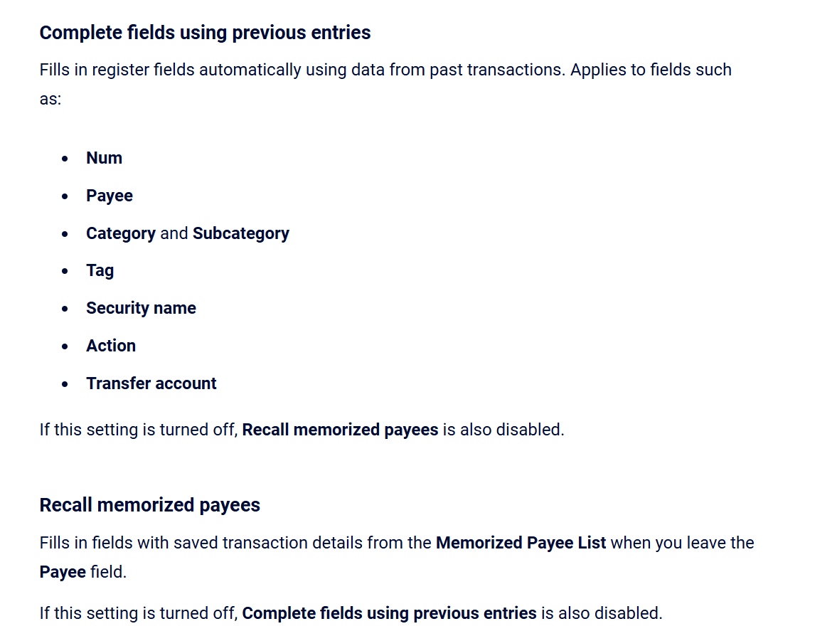

Nobody in Technical Support was aware of the behavior, and this field was in the preferences. Further, the help section makes no mention of this field affecting "Invoicing" (see the following).
Perhaps if Quicken just devoted a little time in researching the bug, they may have found that this is now a "Feature" and not a bug! Perhaps someone knows when this flag appeared or which version turned it off. Quicken needs to update their documentation and/or correct this if it is a bug.
