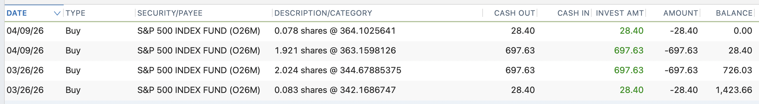

    That cash balance adjustment you mention (a "Placeholder") will always keep adjusting to keep your final balance correct as reported by your 401k holder. That is likely $0. The goal, while not necessary, is to have all your paychecks represented showing all the "Cash In" so the Placeholder doesn't even exist.
    If you setup your paycheck to transfer $ into your 401k ("Cash In") , the resulting buys for that pay period should negate them bringing your balance back to zero each pay period.
    Since these Buys are all the same fund, my guess is(?) is that you got paid on ~3/26 and contributed $697.63. Is the $28.40 on the same date an employer contribution? If so, and depending on how this works in the real world, you will want to adjust your paycheck split or setup a separate bill reminder for the employer contribution.
    In short, you will want to have cash in transactions on 3/26 and 4/9 for a total of $726.03.
    I am not a gambling man, but I suspect you also had a paycheck with a contribution of $697.63 around 3/12. That is the missing amount based on your running balance. That balance should increase by contributions each pay period, and return back to zero after the buys.

    So after adding the account it created an adjustment of the total balance as cash and then all of the purchases, ultimately bringing the cash balance to zero. All of the transactions are "Cash out" in nature.
    You're saying that my paycheck transfer will show as "Cash in" and then downloaded transactions will only show as "Cash out"? If I wasn't tracking my paycheck would the account slowly start to accumulate negative cash value over time? Seems that way.

    Yes, there is a live opening balance, representing some amount of cash, and a placeholder (the actual type listed in the register) which is listed as adding shares. The subsequent transactions are all cash out reducing that opening cash balance to zero.
    You are correct, I was paid on 3/26 and 4/9. The $697.63 is the combined employee/employer contribution and the $28.40 is a separate 401(k) loan payment that is taken from my check. These four transactions are just the four most recent transaction in the account.
    I currently have my paycheck set up to represent both my contribution and my loan payment. I have a separate reminder for my employer match. I will keep this set up in a separate backup file until my next paycheck on 4/23 and see how it turns out.

    Those placeholder transactions will reduce to not being required the more detail you flesh in. How much older history you have will likely drive what you do. Regarding the cash:
    1. You can always go back to older paycheck transactions and show the cash flow to the 401k account. The more transx you modify, the more correct the running balance will be as the cash balance (live balance) placeholder will auto-adjust. You could do this to the earliest transx provided by your 401k provider.
    2. If you don't feel like modifying your older paychecks, you could always enter a "Payment/Deposit" transx in your 401k account at each pay period to cover the buys for that pay period. This will keep the balance at $0 versus a large adjustment that gets adjusted downward until $0 as reported. Your live balance placeholder will, again, adjust in real time as you enter each $0 where it will dissapear.
    The Add Shares placeholder works in the same way: the more transactions you enter, it reduces down to not even showing. You could certainly manually pull your older data from your 401k provider and type it in (if they provide it), but I don't know if you wish to do that.
    I mention this because that Add Shares transaction will be missing the Cost Basis info that is needed for performance metrics. You may/may not be interested in that.
    Manually typing in all the investment history will give Quicken the cost basis, but, again, you might not wish to do that. You can alternatively add the cost basis to the Add Shares placeholder by editing it.
    In your case, the cost basis to enter in the placeholder would be the difference from what is currently reported by your 401k holder less the sum of your buys/reinvests that got reported.
