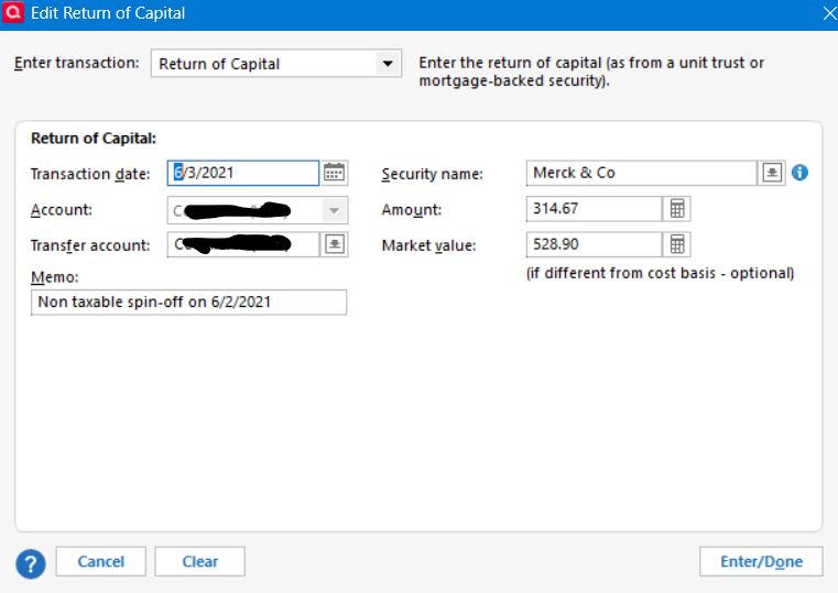

    For a single lot spinoff, all the pricing info is moot. You only need two or three transactions. As I processed the deal starting with 150 Merck shares in one lot with a basis of $6,685.50, I found my FI subsequently reported my Merck basis dropped to $6,370.83, a drop of 314.67 or 4.707%. For reference, the Form 8937 filed by Merck suggested 4.77% as a justifiable transfer. That Form 8937 value is not binding, only a suggestion.
    I also noted the Organon closing price 6/3/21 was $35.26. For the 15 shares received, that meant a market value of $528.90.
    Those values led to this Quicken transaction:

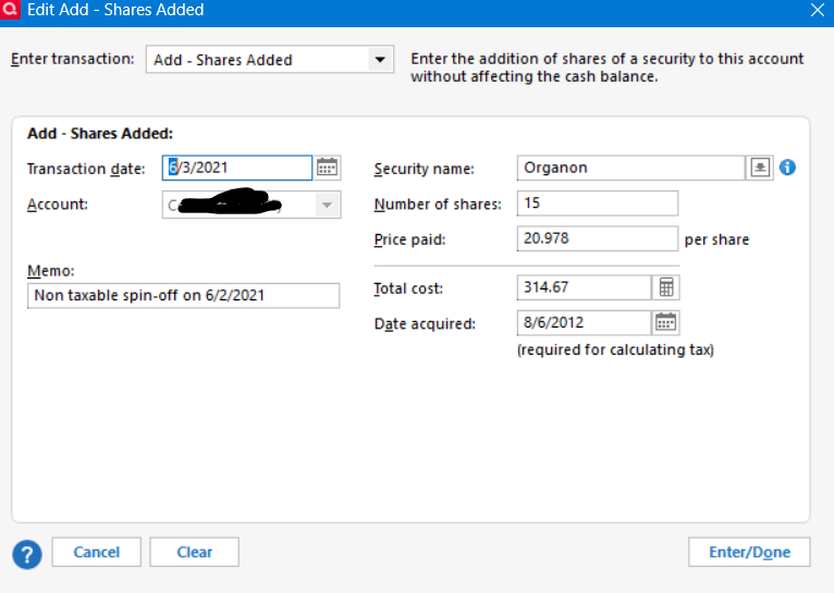

    The second transaction is the Add Shares of the spinoff Organon. For my case, that looked like this:
    The number of shares is 1/10 the Merck shares. The Total cost of the drop in the Merck basis. The Date Acquired is when the Merck shares were acquired.
    If the 1/10 ration had generated a fractional shares, there would have followed a Sold Shares transaction for that fractional share with a Total Sale value equal to the cash-in-lieu received. That sale would have dropped the basis of the remaining whole shares of Organon by a small amount. That is, after the sale, the total basis of the remaining Merck and Organon holdings would be less than the pre-spinoff Merck basis.

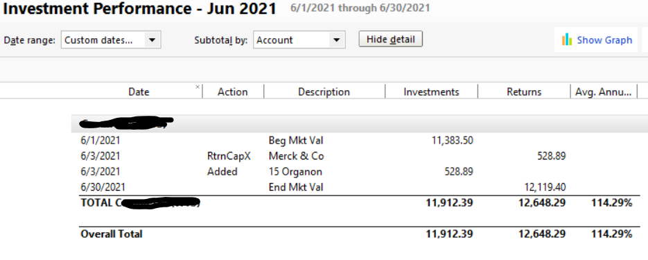

    One of my key targets for spinoff events is that they be neutral for investment performance. That is reflected in an Investment Performance report which comes out like this:
    The point here is not the 114.29% Average Annual Return which is a meaningless value when annualized from a one-month period. The point is that the 528.89 is both an investment and a return on the same day, thus do not impact the Average Annual Return calculation.
    Hopefully, with this example, you can add a RtrnCapX transaction to your records and edit the Add Shares downloaded to match as necessary. I would focus on matching the final basis data and bypass that your brokerage made two adjustments in getting there.
