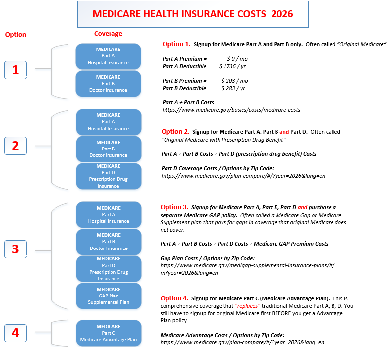

WHAT ARE THE COST AND COVERAGE OPTIONS FOR MEDICARE?
There are a number of Medicare options to consider, all with varying costs, coverage rules and financial risk exposures:
- Original Medicare, Part A and B
- Original Medicare plus Part D, prescription drug plan
- Original Medicare plus Medicare Gap or Medicare Supplement plan
- Part C, Medicare Advantage Plan
To help determine expenses for the 4 options, I've included links to cost and coverage information for the 2026 year. Costs for Part A and B are fairly straightforward. Part D, Supplement Plans and Advantage Plans are quoted by zip code and provide actual plan detail and costs for your local area.
- Medicare Part A, Part B, Part D, Part C and MediGap Overview
- Medicare Part D, Prescription Drug Plan Costs and Coverages (zip code based search)
- Medicare Gap (Medigap) or Supplemental Plan Cost and Coverages (zip code based search)
- Medicare Part C, Advantage Plan Costs and Coverages (zip code based search)
- Don't forget IRMAA…You may incur higher costs for Part B and D based upon a high MAGI.
