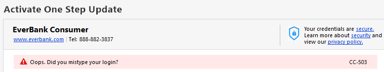

Well, don't know what's related or not today, but yesterday all was well and now Everbank spins with just an updating message. Also, Blue Federal Credit Union (BFCU) spins with 'looking for your accounts after it sends me a 2FA text. But never gives me the window to enter the code.
Here's my latest OSU result. All non EWC+ accounts downloaded properly. OSU hung up for a couple of minutes then completed with all EWC+ accounts downloaded but Everbank. It had a CC501 error. Problem with Quicken Server connecting.
So, it's better than going through MFA every time… just takes a little longer and saved me the trouble of removing it from OSU. I reported the problem as Quicken Anja recommended. So, it seems like something is happening between Everbank and Quicken servers. Maybe Everbank is trying to fix the problem they said they didn't have?
Everbank is connecting again. Sadly it still requires MFA. Will try reaching out to Everbank again as Quicken Anja and we have alerted Quicken and they are working it. Hopefully we can get Everbank and Quicken teams talking to each other.
I saw in the related community alert that Ticket #11551004 has been resolved. This morning both Everbank and Blue Federal Credit Union connections are working. Re: Jnic MFA comment above, both Blue and Everbank have required me to send the MFA text and enter code, but it is all working fine. I think for security, they will always require that, but it is working FWIW.

Today I find that, while I'm not being asked for MFA when running an update, nor is anything getting downloaded, although I see cleared transactions for recent days when I look at my Everbank accounts. I downloaded QFX files from Everbank in an attempt at a workaround, but when I import one I get this pop-up message:
Please open the Everbank downloaded QFX file with Notepad or Wordpad and look at the first few records. You should find the following records in it:
<FI> <ORG>B1 <FID>????? </FI> <INTU.BID>?????
What does your QFX file look like? What numbers are there in place of the "?????"
The number must be listed in the financial institution directory file, FIDIR.TXT. If not, you get the above error message.
If it turns out that the number is indeed incorrect, only Everbank can fix it, because they create the QFX file.
