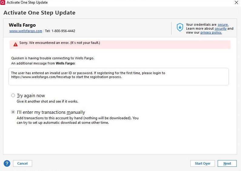

Was working fine until Sunday 5/18/2025 when Quicken suddenly made me reauthorize ALL of my accounts. All accounts except Wells Fargo, Bank of America and Charles Schwab reauthorized successfully.
@DOS for your Wells Fargo accounts, you need to log into the website provided to verify your identity. After you successfully do so, you will have 10 minutes to return to Quicken and complete the process.
@DOS the error message you got is for a Direct Connect connection. I wanted to point this out just in case you weren't aware of it.
Thank you for your post. For the record the error message I posted is after successfully logging into the Wells Fargo site from Quicken and being returned to Quicken. As I posted everything was working fine until Sunday when for some unknown reason Quicken required I reauthorize all of my accounts. In addition if you read the error message, it's not my fault.
@DOS I can't speak to the other error messages your received for your other financial institutions, but the one you received for Wells Fargo is a standard message that indicated that you need to verify your identity to use Direct Connect. It really isn't an error, but an extra step needed.
