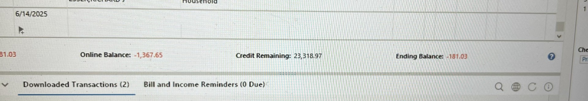

In all transactions the balance is $54,000. The register shows $181 balance. How do I fix this?

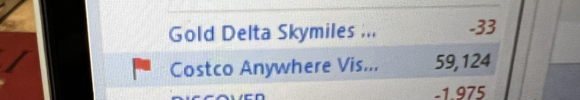

And, why does the website show 59,124 when the Online Balance in the register (which is a downloaded, not calculated amount) only show $1,367.85? This is looking like a very screwed up account to me.
