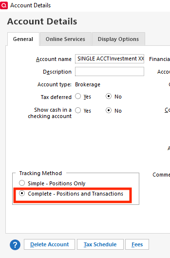

Thank you for letting us know you're encountering this issue. What you describe sounds like your investment account ended up in Simple Investing instead of Complete investing. If that is what happened, then to fix it, when you're in the account, click the gear icon near the upper right, select Edit Account Details, and on the General tab, near the lower left, click the radio button next to Complete - Positions and Transactions, then click the OK button.
I have same issue as @tbf47 - per Kristina suggestion above, I tried to change to 'Complete' but it is 'greyed' out and I am unable to change from 'Simple' to 'Complete'. What's happened to Quicken vis a vis EJ, since this has been working for over a year now.

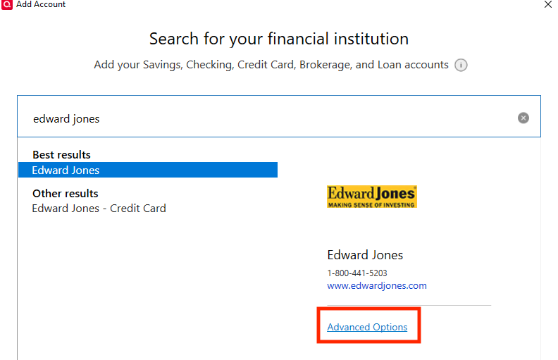

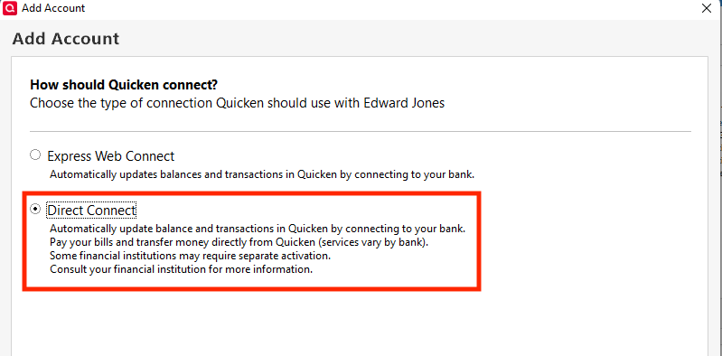

Once that known issue is resolved, I recommend that you backup your file, deactivate the problem account(s), then navigate to Tools>Add Account. Search for Edward Jones. Click the Advanced Options link.
Read the information screen, click continue, then make sure Direct Connect is selected, and click Next.
Follow the prompts. When you get to the Add/Link screen, make sure to carefully link your account(s) to the correct nickname in Quicken.
