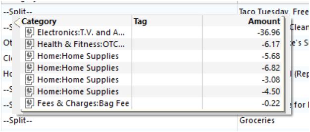

@UKR @Jim_Harman I think there is some confusion as to which split detail is being discussed. When you hover over a split transaction, you will see a pop-up that shows the split -
In that pop-up box that shows the split, there is no way to suppress the Tag column. I don't use tags in any of my account registers, but this Tag column always shows up.
@trburns57 please confirm if this is the split pop-up box you are referring to.
@CaliQkn @Jim_Harman Yes, that pop-up box is exactly what I'm asking about. My apologies for any confusion. As I stated in my previous message, the Tag field is unchecked in my register settings and the field does not appear there. However, it did show up in the split transactions pop-up.

There already is an Idea - type discussion to request a change to this popup menu.
Please seeMemo not shown in split hover — Quicken
Review this Idea and vote on it. If we get enough votes, the programmers will consider it for implementation into a future release of Quicken.
@UKR thanks for the link to the enhancement idea. I added my vote. It's not a big deal, but if possible, I would like the ability to remove the Tag column and add the Memo column.
