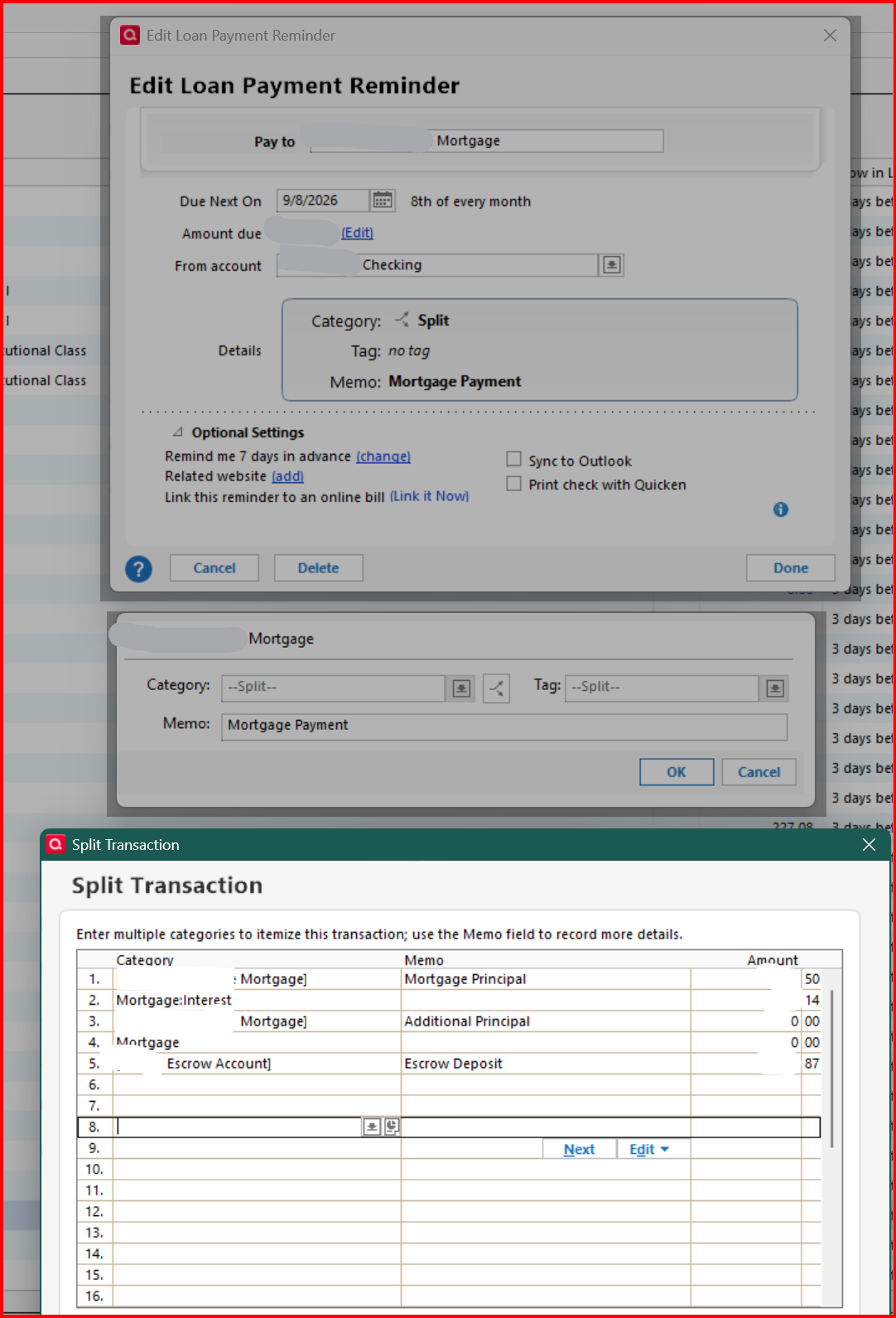

    I didn't explain good enough what I wanted to know.
    When you go to bills and income.
    How do I change the "monthly payment" principal and escrow split transactions amounts.

    @ccpjr when you change the payment split in Payment Details, it should automatically change the payment reminder in "Bills and Income" as well.
    You can also go to into your "Bills and Income Reminders" (Ctrl-J) and adjust the split in the payment reminder.
    It is also important to keep the default split lines intact and in the same position. Quicken uses these splits to calculate the P & I split. That is why it is safer to go into Payment Details in the mortgage loan account to change the payment split.

    I was able to edit the escrow amount to ($556.41), but I can't edit the principle or interest amount.
    The principle and interest total is off by $.021.
    my total payment should be $918.60 but it's $918.8.
    In bills and income, payment reminder for my mortgage. The princable and interest amount is wrong.
    I have gone to my mortgage account and clicked on edit payment details and then edit.
    It opens the split transaction window with and unlabled -35.77 amount.
    File 01 shows the monthly reminder with the wrong total of $918.81
    File 02 show edit payment details in the mortgage account.
    File 03 Shows the window that opens when I click on edit from the edit payment details.

    @ccpjr the escrow amount (556.41) needs to be in split line #5. You have it in #3 which is additional principal. Please refer back to my sample split I provided. Split order and location is critical for mortgage payment splits.
    Make this change and see where things end up. If it is still not balancing correctly there may be other issues with the loan payment set up.

    @ccpjr it is always best to adjust your loan payment components in Payment Details. The reminder gets updated automatically with the splits in the correct placement.

    You cannot edit the principal and interest payment amounts in the loan setup. These amounts are calculated based on the data you input for interest rate, number of payments, loan amount, etc.
    If your total payment is different, the difference needs to be added to Additional Principal.
