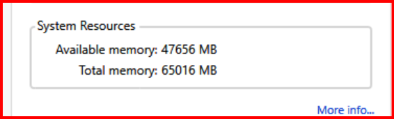

  • @estevehannon just a thought. I used to have the same issue as you do. I use Ctrl- V and Ctrl-C a lot in Quicken. But I realized now, ever since I purchased my latest laptop with 64 GB of RAM, I no longer have an issue with the copy and paste shortcut keys not working.
    I clicked on Help → About Quicken, while holding Ctrl-Shift to get to the System Resources information -
    Just for curiosity, you might want to check your available memory to see if that might be a determining factor for this issue.
  • Chris_QPW
    That is interesting that Quicken's About is now showing the actual system resources of the machine now. (It used to show what the Quicken process actually had access to.) (There is also a new "More info…" that is pretty interesting)
    But this isn't the memory that is available to Quicken. Quicken is a 32-bit application. A 32-bit number and therefore the max memory address, is 4GB. And in fact, because of the way memory gets mapped into a 32-bit application, it typically restricted to 2GB.
    This isn't really a problem though, because Quicken doesn't use that much memory. I just clicked through all of my active accounts to get them cached in memory and Quicken is only using 240MB.
    On the other hand, other programs like web browsers tend to be memory hogs. I could certainly see something like if you had lots of memory hogging processes running, that they might affect the behavior of pasting into Quicken. And if that is the case certainly either adding more memory or restarting Quicken where there isn't as many processes running might affect this.
    Note this can also be a quirk/bug in Quicken, where they are using some old API or such that does get affected by these external factors where you wouldn't see it in other applications. In fact, Quicken overrides a lot of default Windows system GUI like the context menu and the main system window, and that might be part of the problem.
