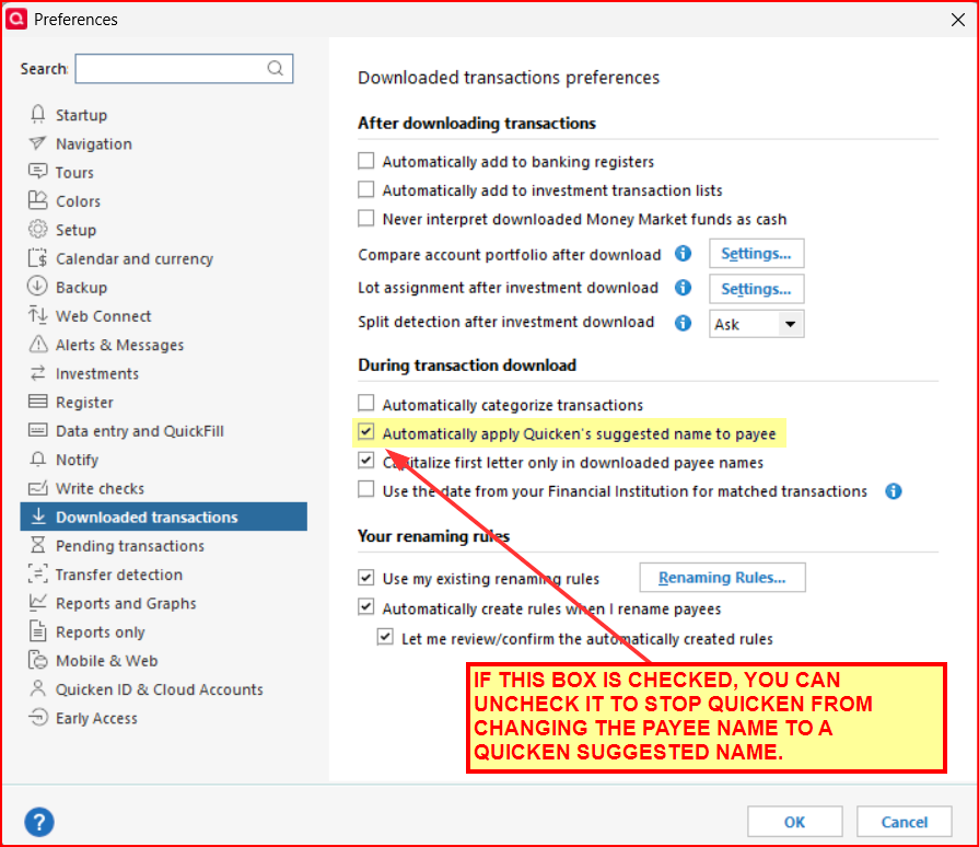

There is a Preference setting that allows Quicken to enter a suggested Payee name when a Memorized Payee or Renaming Rule for the Payee does not exist.
Even if you already have a Memorized Payee or Renaming Rule set up for the Payee, if the downloaded Payee name was changed in any way by the financial institution Quicken might not associate it with that Memorized Payee or Renaming Rule and will then apply the Quicken suggested name.
You can view the downloaded Payee name in the register by clicking on the Gear icon at the top right of the account register. Then click on Register Columns, check the box for Downloaded Payee and click on Done. This will add a column in the register so you can see what was actually imported into Quicken. If you have recurring purchases from this Payee you can sort the register so they are grouped together. Then you can see if there was an change to the downloaded Payee name.
