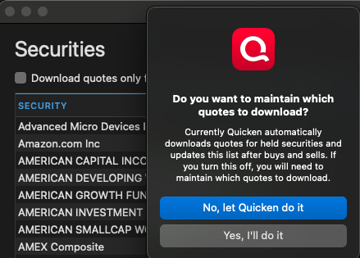

Thanks for your question! You can indeed exclude specific securities from downloading quotes while still updating the rest. Here’s how:
- Go to Window > Securities.
- Uncheck the option “Download quotes only for Watchlist, indexes & securities held.”
- You’ll see a message pop up (screenshot example below). Select “Yes, I’ll do it.”

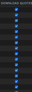

- A new column will appear titled Download Quotes with checkboxes.
- Simply uncheck the box next to the security you want to disable updates for.
This way, all other securities will continue to update normally, while those you’ve deselected won’t.

Thanks, @Quicken Anja, for the prompt and on-target response! I think the downside with that approach is that it appears from the screen shot for step 3 that I then would need to manually update the list of securities every time I purchased a new security. If I bought something and forgot to add it to the list, it wouldn't ever update quotes for that security. Any workarounds for that?
Much appreciated.
@NotTechnical I think you have it backwards - if you buy a new security it is automatically added to the Securities list with the Download option checked - you'd only have to go in & manually uncheck the option if you didn't want it to update prices for you. I've never had to go in & add a security to the list myself unless it was a made-up security that didn't have a real symbol. (For example, I create a security for each I-bill that I purchase; I also created securities for the funds inside my 401K that weren't publicly traded.)
I suppose if for some reason you wanted Quicken to download prices for a security that you didn't own and did not want to add to a watchlist then you'd have to add that to the list yourself; not sure why you'd want to do that.

Thanks, @Jon! That makes a lot more sense. Appreciate your clarifying. I'll give it a whirl.
