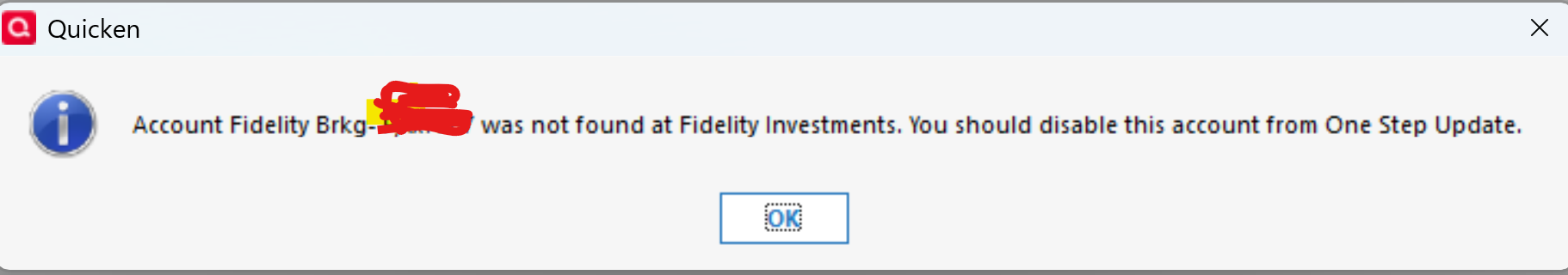

In any event, I went to Fidelity and removed permission from one account, then reset it in Quicken. I was directed to reauthorize it at Fidelity, which I did. Quicken opened a linkage page, but the account said "Do'nt add to Quicken" with no option to override. Then I went to that account in Quicken, initiated an update and got this error-
Interestingly some of my other Fidelity accounts did update this time.

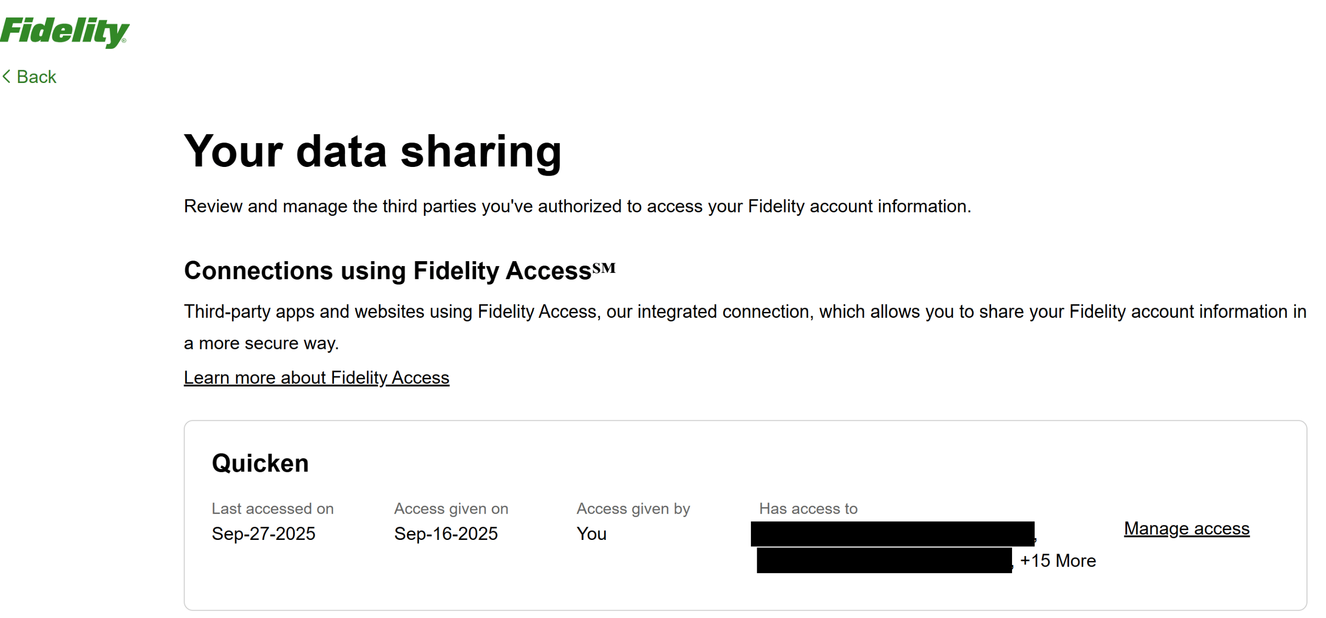

I recorded my most recent paycheck (and corresponding 401(k) contributions) on Friday, September 26. Those transactions were downloaded from Fidelity the following day, and everything reconciled. Fidelity charges their administrative fees on the first day of each quarter, which downloaded to my account on Thursday, October 2. I have been unable to download anything (prices or transactions) the past two days, though, and somehow the share balance for one of my three securities is off. The third-party access with Fidelity is correct. What is going on?
