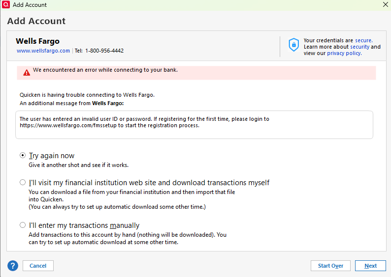

Cannot add Wells Fargo Accounts
Arrive at Add Account screen and enter CORRECT username and password, click connect
Receive this screen in return
https://www.wellsfargo.com/fmssetup no longer exists.
Try again doesn't work. I used to have all my accounts with wells fargo working. why can't I do it now?
This should be automatic. I can't imagine you would leave out the millions of Wells Fargo customers.
How do I get this to work?
Hello @JoeLam,
Thanks for reaching out! The link you mentioned (https://www.wellsfargo.com/fmssetup) does still exist, so I’d like to better understand what you’re seeing when you try to access it. Could you share a little more detail about what led you to think the link no longer exists? Are you getting a specific error message, or does the page just fail to load?
Wells Fargo requires an extra authorization step when using Direct Connect as your connection method to connect your accounts in Quicken:
- Log in directly to https://www.wellsfargo.com/fmssetup
- Wells Fargo will grant a limited window of about 10 minutes. During that time, return to Quicken and complete the Add Account process.
If that window expires, you’ll need to repeat the authorization step again.
