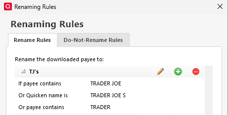

I think if you are willing to rename all the variations of that particular payee to be the same, then yes it can be done.
For example if you shop at five different Trader Joe's, you will have have different payees: TRADER JOE S #110, TRADER JOE S #111, TRADER JOE S #112, and so on. So
(a) First you will create a renaming rule where if the payee contains "TRADER JOE", rename it to "TJ's" (or whatever you like). This rule will rename all variations of that grocery chain to a simple TJ's.

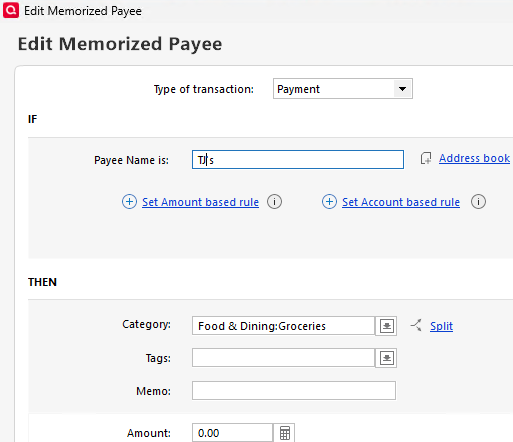

(b) Then create a memorized payee to match exactly what you created in the prior step (TJ's in this example) to be categorized as grocery.

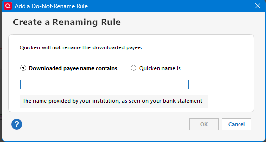

Check that you don't have any Renaming Rules that are looking for parts for the payee names and changing them like a Renaming Rule of "Charity donation". Also, you would want to create a Do-Not-Rename rule for "Charity donation" in Tools → Renaming Rules → Do-Not-Rename Rules (tab)
