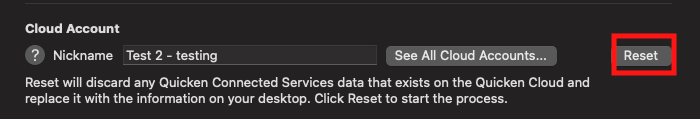

To troubleshoot this issue, first, I recommend that you check your mobile device's app store to see if there are any updates for the Quicken mobile app. If your mobile app is up to date, then next, please try resetting the Quicken Cloud. You can do this through the desktop app by navigating to Quicken>Settings>Connected Services, then clicking the Reset button.
