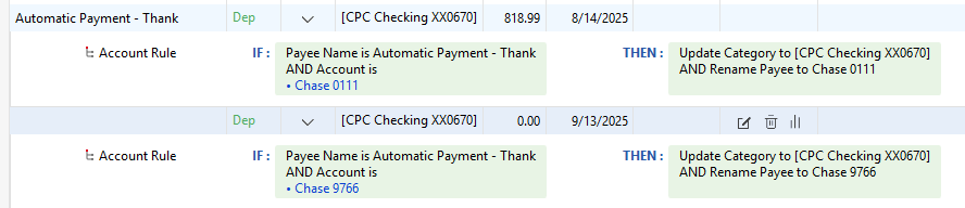

    Whereas I agree with @UKR that pre-entering the transfers is probably the best method I have found something that works for me given the new features for the Memorized Payees.
    Note that for me the transactions always hit the credit card accounts a day or so before the checking account and I download daily so that these rules kick in before the transaction hits the checking account, and as such is just a match to the existing transfer transaction that the above rule creates.
    If you need a reminder for the budget or projected balances, then it would probably just be better to use the reminder and change the transaction to the right amount when it is known like @UKR does.
