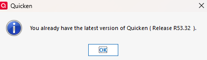

Here's what I'm seeing in the about window as well as when I click on the "Check for Updates" option. I thought it updated itself automatically whenever I run OSU. Evidently that's broken too as I can't recall the last time I saw it update itself.

Are you running Q Canada? Because the latest US Build is R64.30

I am also using US Quicken Deluxe for Windows R53.32 and says no updates available. I also still have an active Subscription. How can I get Quicken to automatically update using the "check for updates"?
I had to manually download from https://www.quicken.com/support/how-do-i-download-quicken-quickencom-after-i-buy-it/ Be sure you download the US version assuming that's where you're at.
