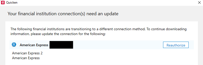

However, after deleting the "new" accounts I went back and did a One Step Update→[one account at a time] to get the Quicken account to link properly with it's online counterpart. But it appears now each time I try to run "One Step Update" it requires re-authorization EVERY UPDATE! So for each Fidelity account I have to go through the "enter code", get the code via phone, then agree to terms (multiple page form with two boxes that have to be checked before "I Agree" button is active) and get to the "re-athorization complete, returning to Quicken" page BEFORE Quicken update request times out. Didn't make the timeout on two occasions.

If you're getting prompted to reauthorize every time you update your accounts, that indicates that Quicken is still seeing one or more accounts connected by the old connection method. Usually, the reauthorization prompt will tell you the name(s) of the account(s) that it sees need to be reauthorized.
To resolve the issue, you would need to remember the account names the reauthorization prompt lists, then backup your Quicken file and navigate to Tools>Account List. If you see the option to "show hidden accounts" at the lower left, select that box.
Then, review the account list to find the account(s) Quicken says needs to be reauthorized. When you find the problem account(s), deactivate it. If it is an account that is closed or no longer in use, you can mark the account closed. If it is still in use, then you can connect it via the new connection method by navigating to Tools>Add Account, following the prompts, and making sure to link it to the correct nickname in Quicken.
