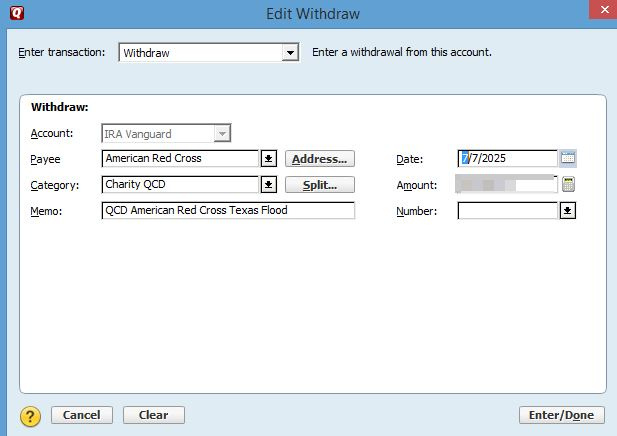

When I turned 70 1/2 I started making QCDs. A QCD is not taxable income even if they cover a RMD. That's the main reason to do a QCD. I just entered the sales in my IRA which gave me a cash balance. Then I made a Withdraw and categorized it to "QCD Charity". I made a separate Category called QCD Charity from my regular Charity donations since the QCD is not taxable.

@volvogirl Do you have the Tax Schedule function turned on in that IRA? If so, wouldn't even that w/d to your "QCD Charity" get called taxable?

I'm not sure. Where is that? I have old 2013 version. My IRA account is checked for Tax Deferred and on the Tax Schedule tab it says Transfers Out to 1099R: Total IRA gross distrib. But I'm not using a Transfer to another account. The QCD is just a withdraw from the IRA account. I don't need to take my RMD until next year when I turn 73. But even then the QCD won't be taxable even if it's for the RMD.

In my current experience, WithdrwX transfer from an IRA are treated as income per the tax schedule setting.
WriteChk transactions are not thus that is my chosen process for QCD transactions.
I do think some tweak in the last few years clarified and aided that distinction.
If I create a Withdraw transaction (no category), tax planner does not treat it as income. If I edit that transaction by making category = [Checking], it remains a Withdraw transaction, but is now included as taxable income in the tax planner.
